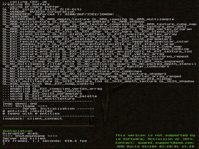

Reply 40 of 64, by Joseph_Joestar
I was using my MSI GeForce4 Ti4200 which normally sits in this system while running some tests on my upcoming socket 754 build (Athlon64 3000+ on an Asus K8V-MX). It surprised me how much better the card performed on that platform.
128.96 KiB
1910 views
In 640x480 using 32-bit colors, the socket 754 system runs Quake 2 at twice the frame rate compared to this AthlonXP rig. Again, this is with the same Ti4200 card. The difference gets smaller as the resolution goes up, but it's still quite noticeable. Pretty interesting.

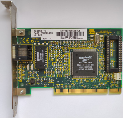

I've added a 3Com 3C905B-TX card to this rig. It's only used to access my retro LAN and transfer files (mainly GOG offline game installers and savegames) from one retro rig to another. All my retro systems are kept completely off the internet.

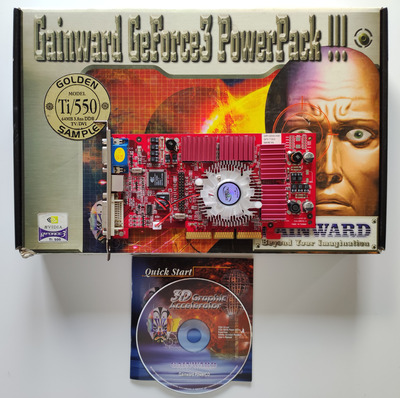

So, back in 2002 or so, I bought a Leadtek GeForce3 Ti200 second hand and used it in this PC. It felt amazing seeing pixel shaders in Morrowind for the first time. About six months later, I got a great deal for a Gainward GeForce3 Ti500 (or as they call it Ti550) Golden Sample complete in box, so I got that one and sold the Leadtek. The Gainward card served me well for several years, but eventually it started artifacting heavily and I declared it dead. However, emboldened by my recent success at SMD soldering, I decided to take a closer look at that card.
I immediately noticed that one of the inductor coils was about to fall off because the solder had dried out. Fixing that was fairly easy, although my work was somewhat messy. That didn't solve the artifact problem though. I then carefully examined both sides of the card using high resolution photos and noticed that one of the SMD resistors on the back also had a cracked solder joint. Since I have a bit more confidence in my SMD soldering skills now, as well as access to better equipment, I managed to fix that too. The artifacting changed, but didn't disappear completely, so my next targets were the memory chips.
I carefully removed the heatsink from each chip using a razor blade (the epoxy was extremely strong) and then started pushing down on the chips one by one (while the card was running) in hopes of determining which one was creating the artifacts. Before doing this, I had also removed the GPU cooler, as that made it easier to access the memory chips. The goal was to find the problematic one, and then reflow it using a soldering iron. However, during this process, the artifacts suddenly disappeared. I wasn't sure what's going on, so I turned off the machine, put a brand new aftermarket cooler (DeepCool V50) on the GPU and reattached the memory heatsinks. Somehow, the artifacts were completely gone. My best guess is that a cracked solder joint re-sealed itself from the extra heat while the card was running without the cooler and heatsinks. Saves me the trouble of reflowing I guess, and the card appears to be working correctly, at least for now.
517.41 KiB
1324 views
170.35 KiB
1324 views

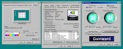

I used my spare Celeron rig for testing purposes and installed Gainward's official drivers from the CD that came in the box. These automatically overclocked the card to 250/550 (wow!) and it worked without any issues. Played a bit of Quake 2 and ran a few loops of 3DMark 2001SE, still no artifacts in sight. I do intend to test this more thoroughly, but I just wanted to share this odd repair story. The reason I'm posting it here is because this AthlonXP system used to house this very card back in the day. I'm pretty happy with the Voodoo3 that I now have here, but I'm also glad that I managed to get my old card working again. 😀
Reply 52 of 64, by H3nrik V!
Is the "Ti550" factory overclocked, since they use that name?
About the solder joint seemingly reflowing it self - it may only be a short time succes, but then you know how to search 😀
Actually, back in the day, I reflowed a complete system board from an IBM Thinkpad T43, which apparently was known for having issues with the GPU. After reflowing in my kitchen oven, system board wrapped in tin foil, it ran for years on without issues. Maybe a graphics card can be reflowed in the same manner?
Reply 53 of 64, by Joseph_Joestar
H3nrik V! wrote on 2023-04-20, 05:45:
Only when using the official Gainward drivers and utilities from the supplied CD. These automatically raise the clocks to 250/550 if you install them in "Enhanced Mode" which is the default option (see pic above). On the other hand, if regular Nvidia reference drivers are used, the card will run at stock Ti500 clocks i.e. 240/500.
After some additional testing, I think it may have actually been my fixes to the cracked solder joints on the resistor and inductor coil that solved the issue. It probably just took the card running for a minute or so to fully stabilize. After making those fixes, I turned the system on, saw the artifacts still being present at boot, and immediately turned it back off.
Later, when I was testing the memory modules, the artifacts went away after roughly a minute of the card running. In hindsight, I don't believe the chips ever got hot enough to reflow themselves, since I was simply looking at the BIOS screen and checking if the artifact pattern would change as I was pressing on each chip. Thinking back, the artifacts actually disappeared while I was not touching the card. I had pressed on two chips, didn't see any changes, and before I was able to press on the third chip, the artifacts went away. To be extra safe, I inspected all memory chips with a bit more scrutiny later on, but I couldn't see anything that looked suspicious.
I'm not a fan of "baking" graphics cards, as that's a temporary "fix" which often doesn't hold up for long, and can damage sensitive components on older (retro) GPUs. I prefer to identify the problematic chips and then reflow them manually, either with a soldering iron, or using a hot air rework station. I don't have the latter yet, but I do plan on buying one eventually.
