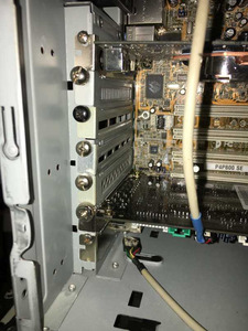

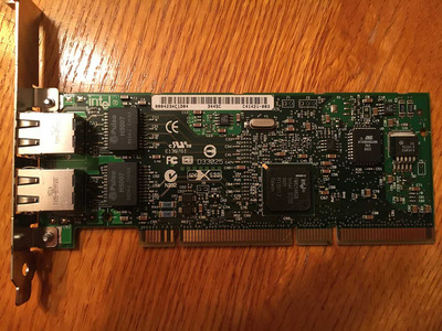

Reply 60 of 88, by Warlord
A nice upgrade here over the Integrated Marvel controller. I bench marked it btw comparing the onboard controller to the Intel controller. While my testing wasn't all encompasing use case scenarios. I basically copied a DVD size file over the network to see which is faster the Intel was like 10 seconds faster. I even tried different settings. Then I tested CPU utilization and Intel won hands down. As the strongest settings on both marvell barely did anything. While the Intel strongest settings reduced full load to under 20% CPU utilization. I don't need 2 ports So ill just disable one. 🤣 its just what I had on hand.

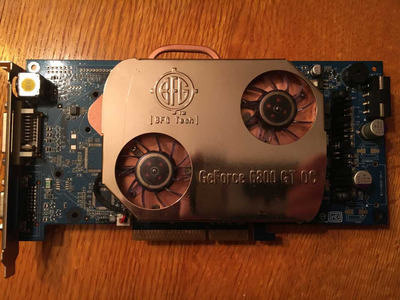

Graphics card is all cleaned up, replaced the thermal pads with the good blue 3m ones and the paste with some Noctua. Also lubed the fans with some 3n1 PTFE oil. During my testing this card has no issue doing a Ultra overclock in fact even after that it still seems to have a ton of head room. Golden Sample? idk great card. Since I did all of this. When I lower fan speed to like 40% it still Idles at like 45c at full power.

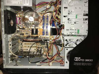

Reply 62 of 88, by Warlord

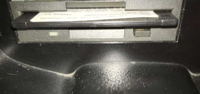

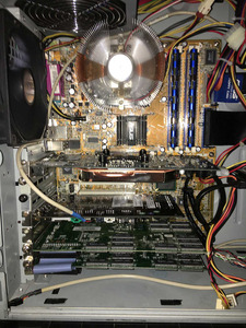

more pics cable management still a bit rubbish

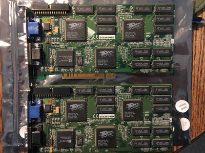

Reply 65 of 88, by Warlord
To Voodoo or not to Voodoo. Or should I voodoo on something else. Matched pair of Diamond Rev A. Your thoughts? or is it a waste of time.

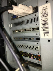

Reply 69 of 88, by Warlord

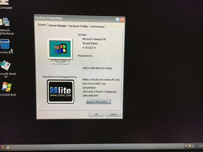

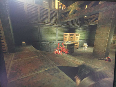

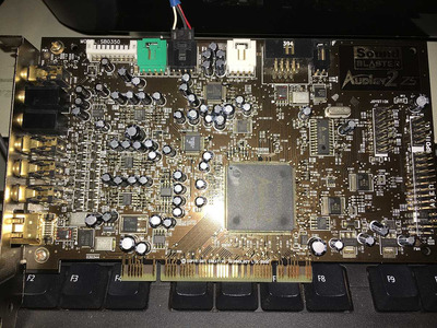

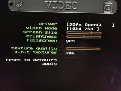

Finally got around to installing 98se, its working just fine with 6800gt, audigy2zs, and 2gb ram with 250bg HDD.
Only thing I had a problem was had to swap out the dual port 1000MT with a normal single port 1000 MT desktop adapter. Since the drivers didn't work with the dual.
IDK if I will do voodoo SLI or not. But I want to get some heatsinks before I try it since I they will run hot with the system how fast it is.
Reply 70 of 88, by havli
I will build similar PC at some point and I plan to put V2 SLI in there.
As for the cooling - some extra airflow should be enough. Passive heatsinks on their own won't do much anyway. And there is also risk of the heatsink falling off one day... and it might short something on the card below and damage it.
Reply 71 of 88, by Warlord
Bitchin Fast, and yah I plan on adding heatsinks to the voodoos and add a fan blowing on them.

I can't remember what you CPU fan is called, did you have to do modifications to fit it? I see them for sale regularly and they look awesome in comparison to the stock one I use on my CT -479.
This is one of the big complains about the CT-479, that it is hard to fit normal CPU fans.

Joakim wrote on 2021-07-04, 19:39:
Ya the mod for the fan, is there are these 2 brackets for mounting the heat sink on a P4. Trick is to flip them upside down so they clear the socket adapter. Then the heat sink retention clip normally would clip onto a socket or clip onto a mounting bracket It has to be modified so that it will screw down into the upside down brackets.
I had see it done a different way than I did it, my way was a lot cleaner and probably easier. Then you could do it without one but I put I think they were 1mm thick thermal pads around the die that were about even with the height of the die so the heatsink would mount even pressure.
