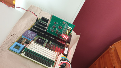

However, yesterday when I swapped boards around, the system decides to lock up everywhere: BIOS, OS on either diskette or hard drive, and so on. I do not see any resource conflicts anywhere and the only way to get the system to power on and act up again and the only one way to get it to unfreeze would be removing the batteries in the battery holder and waiting about an hour to get the settings to delete and setup again.
Not sure where to go at this point and the board itself is in pristine condition, so it could be either a short or something else, but I don't see or hear any crackling or Puff the Magic Dragon smoke.

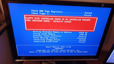

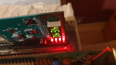

I repaired recently some broken traces an replaced some resistors, capacitors and the sockets for the Bios and keyboard controller. Then i checked if everything has contact and removed the remaining flux but my post gets this code.
At the beginning i had a wrong keyboard controller and the keyboard didn't work but I had a video output so I was able to see the bios boot check on a screen.
Now I don't get a video output and even if I remove ram and Cpu the board doesn't make beep codes.
Any ideas? 🙏

Reply 9 of 22, by BitWrangler
You don't seem to have enough SIMMs in it, if it's DX class. 32 bit data path needs 4 8bit wide 30 pin SIMMs.
Reply 10 of 22, by GuillermoXT
Thanks this was the trick.
But i still don't have a working keyboard and i get this code....what could be the problem?

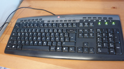

When i connect a PS/2 Keyboard with adapter instead of that one i used with my 286 all 3 LED´s light up for 1 second, go off for a few sec and then on again for 1 second. After that they keep off and the keyboard does not respond in all time. Did someone had the same experience?

Reply 12 of 22, by BitWrangler
Probably going something like this..
Keyboard: : "Hi, I'm a multimedia keyboard with plug and play features, let me tell you abo..
286: "WTF? RESET"
286: "WTF? RESET"
286: "WTF? RESET"

Reply 14 of 22, by GuillermoXT
The strange part is with the multimedia Keyboard i dont get a keyboard error and it keeps stuck on that displayed screen because i can not type F1.
With the old Keyboard only the Numlock LED flashes once. When i try to type during memory count - Keyboard error, Shorting the reset pins for restart - Keyboard error, Turn off and wait and then turn on and let the system as it is without typing anything - no Keyboard error.

I tried this multimedia keyboard on my older Tandon 286 and it worked without problems.
I think like matze79 said in another forum that the 386 must be checked with a oscilloscope or logic analyzer witch i dont have. My new multimeter can only measure frequencies in Mhz
