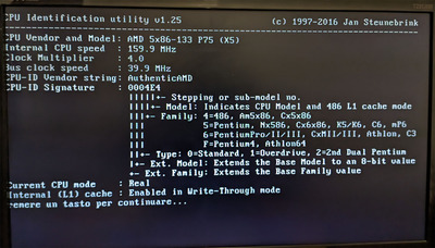

Yes, finally my kingston turbochip on IBM PS/1 see 160Mhz!!! Kid's dream!!!
Thanks epictronics, Thermalwrong

Reply 26 of 29, by theelf
totio wrote on 2023-05-22, 12:22:
Oh thats great!! i will love to have a 486/5x86 +100mhz in my IBM, but i dont find interposer in any place to buy, and overclock my DX4-75 to more than 100mhz i think will not work for sure. What combination did you use for 40mhz bus?
Reply 27 of 29, by totio
theelf wrote on 2023-05-22, 12:50:
R175 populated only.
Reply 28 of 29, by theelf
totio wrote on 2023-05-22, 13:04:
Thanks! yes, i believe, i tested yesterday i did same mod, and no boot, 40x3 is too much for the DX4/75mhz, but i wanted to be sure, thanks
