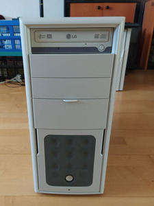

#7: year 2005 build …
GPL-2.0-or-later
My rating: 3,5 from 5 stars

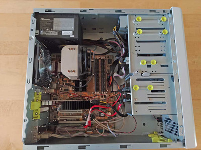

Description: Nothing special about this PC except it is the only one in my collection with HDD raid.
Board: ASUS P5P800 REV. 1.0.1, Socket 775, ATX
CPU: Pentium 4 HT, P4-530 (Prescott), 3,0 GHz, Hyper Threading (with AC Freezer Pro 7 CPU cooler)
RAM: 3GB (2x1GB+2x512MB) DDR 1, PC3200, 200MHz FSB
2D/3D: Palit XpertVision ATI/AMD Radeon X850 XT, 256 MB GDDR3, AGP 8x
Sound: ADI AD1985 SoundMax (Onboard)
HDD: 2x 250 GB Sata HDD, Seagate Barracuda 7200.9, Raid 0
Raidcontroller: Adaptec Serial ATA RAID 1210SA, PCI
ODD: DVD Multidrive, LG GSA-4120B, IDE
ZIP-Drive: Iomega ZIP 250, IDE
Case: InWin IW-C588
PSU: Seasonic SS-380GB, 380 Watt ATX
OS: Windows XP Pro
Games: Doom 3, Far Cry, SH: The Case of the Silver Earring, Return to Mysterious Island

REM: I never had the money nor need to build a PC with HDD raid but for this one I gave it a try.
The effect on the performance is major but it also confronted me with some challenge ...
... I always make a full HDD Image when I am done with the SW installation but my usual tools can't deal with the neccessary raid driver.
But finally, I found a solution that worked with Windows XP+Raid+Boot-CD, but this is another story ...

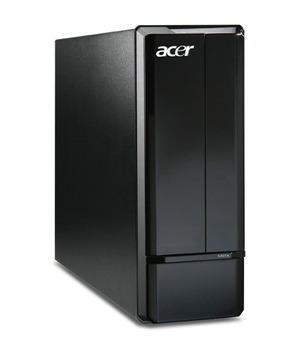

#8: year 2008/2009 PC (Acer OEM not built) …
GPL-2.0-or-later
My rating: 3.5 from 5 stars
Description: Nothing special about this PC but I love the SFF case.
I's alway astonishing what Hardware can be sqeezed in such a small case without utilizing notebook technology.
Board: Acer WMCP78M (MB DA061/087L), nForce 720a Mainboard, Socket AM2
CPU: AMD Athlon 64 X2 5050e 2.6GHz Dual-Core
RAM: 3GB (2GB+1GB) DDR 2, PC2-6400
2D/3D-Grafik: Radeon HD 4350, 512MB DDR2, PCIe (+ GeForce 8200 IGP)
Sound: Realtek OEM, onboard
HDD: WD Blue 640GB (2008) WD6400AAKS
ODD: HL Data Storage GH40F Super Multi DVD Rewriter
Cardreader: built in OEM
Case: Acer Aspire X1300
PSU: Acer OEM 220W, TFX
OS: Windows Vista (32-bit) - IMO Vista isn’t as bad as always claimed.
Games: Plants vs. Zombies, Angry Birds, Machinarium, Mass Effect 1*, Runaway: A Twist of Fate
* Just yesterday I've bought a Radeon HD 4650 1GB low profile, the 4350 is simply too weak for Mass Effect 1 …
27.1 KiB
2098 views
Product image
GPL-2.0-or-later
I am sorry to present this boring one today. Perhaps I should have arranged the presentation to put the most exciting ones last,
but maybe the last one (#9) will be a bit more interesting even when it is the latest by chronological order.
... so, there is one more to come.

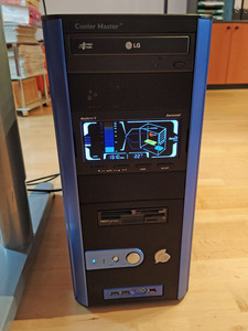

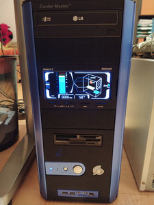

*** work in progress ***
#9: year 2011 build (REM: this one is not fully period correct) …
My (preliminary) rating: 5 from 5 stars
Description: This is my Freespace Battlestation PC that runs Freespace SCP with my Microsoft Sidewinder Force Feedback Pro Joystick (Windows XP).
((Back in 2011, I had the choice between the Phenom II X6 and the i7-2700 and chose the i7, but for this build I took the best 95W Phenom II X6 available.))
The Xmas-Highlight for me is the display of the “Aero Cool, Modern V” fan control. I had one around 2009 and loved the Star Trek(ish) look of it 😀
Together with the “Centurion 5” case (deliberately bought a blue one) it is IMO a great combo.

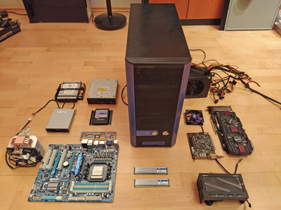

Board: Gigabyte GA-880GA-UD3H rev. 2.1, AMD 880G, Socket AM3
CPU: AMD Phenom II X6 1065T, HDT65TWFK6DGR, 95W (with AC Freezer Pro 7 cooler)
RAM: 8GB (2x 4GB) DDR3 1333MHz, CL9, Team Group
2D/3D-Grafik: Asus GTX 670 DirectCU II, 2GB GDDR5 (GTX670-DC2-2GD5)
Sound: Creative Labs SB0220 Sound Blaster Live! 5.1, PCI
SSD: 128GB Intenso SSD, Sata
HDD: 250GB, Western Digital Caviar RE WD2500YS, Sata
ODD: LG Super Multi DVD Rewriter, GH22NS50
FDD: TEAC FD-CR7, Floppy & USB card reader
Case: Cooler Master Centurion 5, blue
Fan controller: Aero Cool, Modern V *
PSU: 500W, Cooler Master RS-500-ACAB-B1, ATX
OS: Windows XP & Windows 7 (dual boot)
Games: mostly Freespace SCP 1+2 with my Microsoft Sidewinder Force Feedback Pro Joystick.
With a large wide screen display and the Force Feedback the game gives you great immersion.

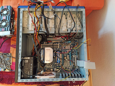

I would have liked to get this project finished by Xmas, but we had some family emergencies to cope with.
234.05 KiB
2066 views
patient in the surgery but still breathing
GPL-2.0-or-later
But anyway, I stitched it up so far to give you at least a first impression what it will look like 😀

I wish you all a merry Xmas, a happy new year & please, please stay all well!!!
* I want the Display to show the temp & fan speed but the fans should be controlled by the built in fan controller of the mainboard. For that I need to build some custom splitter cables first …

That is an excellent system you really did save the best for last. Also great choice on the case that's got to be one of my absolutely favorite cases. This was a really fun thread. Have a safe and merry Christmas and a great holiday season.

it's the typical Star Trek "Michael Okuda"-Look that I like on this display.

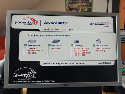

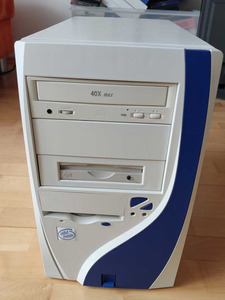

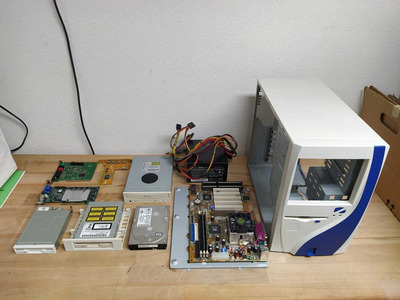

#10: year 1999 build …
My rating: 4 from 5 stars
Description: This is my new Voodoo 3 gaming machine, that replaces the #3 Voodoo 2 machine that I’ve sold recently.
I was even able to connect one of the front USB-Ports to the additional USB 2.0 card.
(luckily there are working Win 9.x drivers available for the VIA VT6212L chip)
The soundcard is probably not the best one, but at least it comes with drivers for DOS.
Board: Gigabyte, GA-6VXE7+ Rev. 3.0, VIA Apollo Pro Chipset
CPU: Pentium III, Coppermine, 1Ghz
RAM: 512 MB (2x256MB) SDRAM, PC-100, Noname
3D-Grafics: Voodoo 3 3000, 16MB, AGP
Sound: Sound-Blaster 64V, Model: ES1371, PCI
USB card: Trust HU-3150, 5 (4+1) Port, USB 2.0, PCI
HDD: Quantum Fireball EX, 4.3GB, IDE
ODD: CD-ROM 40x, LG CRD-8400D
FDD 1: 1.44 MB 3.5", Mitsumi
RDD: Iomega Zip 100, IDE
Case: NoName Mini-ATX
Case fan: 1x 80mm Lüfter (NoiseBlocker)
PSU: ATX 350W, Be quiet! Pure Power, BQT L7-350W
Windows 98SE (incl. Updates)
Favoured Games: Amerzone, Freespace 2, Indiana Jones and the Infernal Machine, The Longest Journey, Klingon Honor Guard

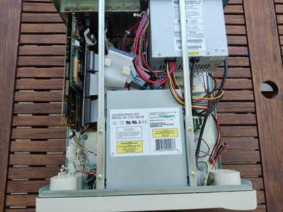

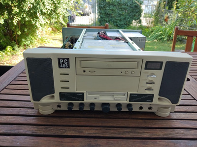

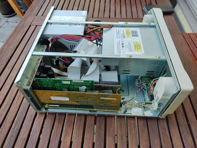

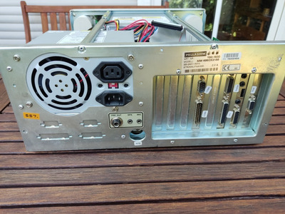

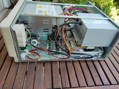

Project #11: a 1994, 486/66 Multimedia machine - work in progress
Description: this will be my second 486 machine.
The case is a real beauty and I was tempted to use it for my "Max Pentium machine" (P 233 MMX/Matrox Mil II + m3d PowerVR II/...) but decided to rebuild it with all salvagable original HW parts.
Unfortunately the VLB-Mobo was gone due to a very bad battery leakage but I was able to get a good replacement for a reasonable price.
I also replaced the (dubious) china-PSU with a tested SPI-300G.
Work in progress: did the most of the assembling today but I think it will take some more work to have it up an running.
I am especially worried about the HDD, because it showed some problems when I've initially tried to make a image file from the original content.
Unfortunately I have no period correct replacement, only a 1.2 GB Seagate Medalist from 1997 🙁
Board: TMC PAT48PG 0.30 (OPTi 895) 486 VLB, Opti chipset (drum battery replaced with button cell)
CPU: Intel 486 DX2/66
RAM: 16MB SIMM
2D-card: Cirrus Logic CL-GD5428, 1MB, noname, VLB
Sound: ESS688FC, noname, ISA
Controller: noname contoller (2x IDE, 1x FDD, 2x serial, 1x parallel, 1x Gameport), VLB
HDD: 540 MB, Conner CFS541A, IDE
ODD: CD-ROM 4x, Aztech CDA 468-021
Case: Unknown Multimedia case with built in speakers and amplifier (PC brand: Palladium)
PSU: AT SPI-300G
OS: TBD (probably DOS 6.22 + WfW 3.11)
that's a (3 years later) period correct upgrade though! 😀
nice case too
