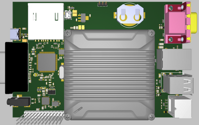

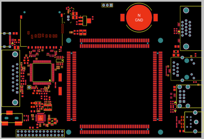

Reply 774 of 912, by Vridek
I wrote to ICOP last night. I'm waiting for a response. Otherwise the news is happening see attachment. Unfortunately it is not ready yet. The big problem now is the availability of SOM. It needs its own SOM.

Reply 775 of 912, by Duffman
@Vridek
So the fix for the SD card slot issue is not going to be as simple as a BIOS update?
also curious, what changes have you made to the WeeCee board?
MB: ASRock B550 Steel Legend
CPU: Ryzen 9 5950X
RAM: Corsair 64GB Kit (4x16GB) DDR4 Veng LPX C18 4000MHz
SSDs: 2x Crucial MX500 1TB SATA + 1x Samsung 980 (non-pro) 1TB NVMe SSD
OSs: Win 11 Pro (NVMe) + WinXP Pro SP3 (SATA)
GPU: RTX2070 (11) GT730 (XP)
Reply 776 of 912, by Vridek
Duffman wrote on 2023-02-13, 14:40:
@Vridek
This is just an experiment. It's untested, and if the SOM can't be solved, it will remain on paper. I have not revised or built the board.
Changes
1) Revision of components
2) Resolved grounding of some components and Ethernet.
3) Removal of microSD
4) Removal of microUSB
5) Integrated MIDI
6) 2x USB
7) Battery insertion option for bios
😎 Added option for power button
Theoretically repairing the BIOS won't be a problem but I'll know in a few days.
