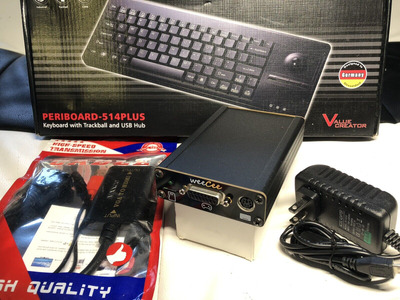

Okay, last one that I have up for sale is an earlier Series-I build that I had reserved originally thinking I could use it in a contest or something silly like that but in the end decide that I rather put it up for sale and find it a good home: https://www.ebay.com/itm/335100866875
It's the last one outside of SN14 (which is still out on Loan and will be going out to Ron after Adrian Black is done with it), which will be the absolute last one I ever will sell but that will be a far date in the future.
The SN3 listing also includes this dorky PS/2 keyboard that I got thinking that I could "snazzy up" the original listings with it (because I didn't know if anyone would want one), as well as this cheapo inline VGA->HDMI converter that I had to go to town trying to find that could support DOS screen resolutions.
I likely won't sell SN1 since it is my own personal device, and is kind of a mess. SN2 was a world better than SN1, but likely won't see SN2 on sale anytime soon. SN3 however was my first truly decent build that shows a huge increase in technique and skill and came out really well. I have had it packaged on the side of my desk for about a year now and decided that it's time to see it go to a good home.
So if you're in the market for a weeCee, SN3 is the last one you'll see from me until I get SN14 back. I don't have the card credit available for another run unfortunately, but am open to any ET/electronics jobs if you know any that are actually hiring.

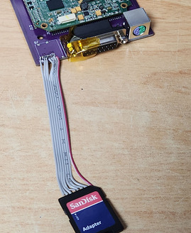

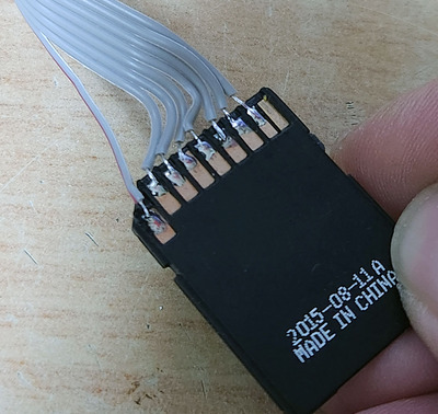

Thank you for your advice on my issue.
I took your advice and took the time to try the dumb way.
268.04 KiB
1797 views
261.63 KiB
1797 views
I have tried soldering the SD card adapter directly to the board.
(Also, I double-checked and triple-checked the motherboard and connectors.)
However, both boards still don't recognise the SD card.
Could there be an IDE problem with both boards at the same time?
I wish I could fix the recognition problem, but I'm at the point of giving up.
Do you have any other advice for me?
Thank you.
P.S.
Funnily (or sadly) the
everything is fine except for IDE detection.
VGA output
PS2 keyboard
FreeDOS USB booting
CS4237 sound card output

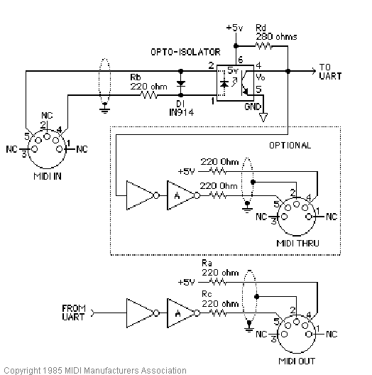

The Serdaco DB15 MIDI adapter (plugs into the weecee's joystick port, creates 2 MIDI outs for up to 2 external MIDI modules) is a perfectly valid solution which only requires a male to male standard MIDI cable to complete the data link.
Upside: very easy to use, throw money at a problem and be done with it
Downside: you can't use a joystick at the same time
In order to get sound out of it, one option is to use the MT-32 L/R jacks to a set of speakers dedicated to the MT-32, or use the mini-jack's single stereo output of the SC-55 to get to a dedicated set of speakers. I don't like to have a set of speakers for each sound producing device, so more on this below**.
The Roland UM-ONEmk2 MIDI interface will probably not work with win98se (I can't say 100% for sure, but I would be extremely surprised if it did) and is more useful for more modern PCs. USB support in Win98se is often met with problems, though you can get by with the simplest devices (mouse, disk drive, etc).
If you want to have it all (MIDI at the same time as joystick), BUCKLE UP.
Here's what I did: I took pin 12 of the DB-15 joystick port's output and sent it to a little breakout board with a DIN5 MIDI socket, like so (BEWARE, I bought a bunch of diodes from aliexpress and they were surprisingly marked the WRONG way, as unbelievable as it sounds; this is why it looks like it's bringing IN a midi signal but it's in reverse, it's pushing it out to the socket instead, out into the external MIDI module).
This is only reproducing what your DB15MIDI from Serdaco is doing, but WORSE. There's only 1 output instead of 2. However, I have to combine that with another self-made Y-split cable that takes all the useful pins of the joystick port and splits into a joystick socket and a MIDI out (pin 12 is used for MIDI data, a 5V pin and a GND pin are also used) socket. Here's what it looks like (connector at the top goes to the WeeCee and the bottom 2 connectors are for a joystick and my MIDI custom cable above):
All together on my weeCee:
So, if you are adventurous and want to go down that same path, this DB-15 pinout will be useful:
https://allpinouts.org/pinouts/connectors/inp … ck-pc-gameport/
As for the MIDI breakout board, I only reproduced the small simple MIDI OUT part of the diagram of this ("UART" is the joystick port on your WeeCee, only 3 pins are used, 5V, GND and MIDI OUT):
