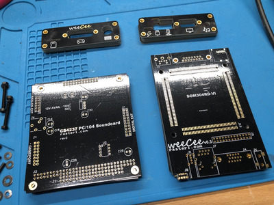

1.0mm plates installed.
On one of my 2 units, the tolerance is stretched to its limit and I had file the external short side of the microsd hole just ever so slightly so that when I push to eject, it has enough clearance to just barely get out. Before I did it, it would rest on the interior surface, spring coiled and the only way to remove the card was to unscrew the whole plate. It would send the card flying as soon as it found enough give to go out.
I still have to push-bend the plate to help the process but at least it's possible to remove it.
I lucked out better with the other unit and it's much more forgiving.
Suggestion for future builds: just open up the hole a few mms in all directions (mostly up and outwardly).
Comparison betwen 1.6mm and 1.0mm

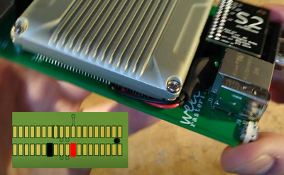

2) Could you help me figure out the connector to solder to for the external battery? From what I can tell from the SOM304RD-VI spec sheet , it lists pin 59 of J2(B) as VBATT, but no specific pin for the VBat- pin. I assumed at first you could maybe hook it up to any GND pin, but I noticed in the Vortex86DX datasheet that R21 and P21 are the respective VBat+ and VBat- pins (but that's on the socket of the chip itself). Across from pin 59 is pin 60 which is listed as SPEAKER, and there are a few GND pins nearby (51 and 54) but nothing directly next to pin 59... Is there a specific pin for the VBat- pin or is any GND pin good enough? What pins did you wind up soldering yours up to?
Any ground pin will do.
My video covers this briefly : https://youtu.be/2P1E2vjpcRo?t=604

Awesome, thank you rasteri! 😄 I feel like a goof having missed that in your video, videos of which I have watched several times now. Thank you so much for your replies!
Actually, @rasteri, are you okay with us building these and auctioning them off on eBay? Hate to see perfectly good PCBs go to waste.
(Edit: Attached vbatt pin hookup and relevant image from video rasteri linked to above)
    236.01 KiB
    1199 views
    weeCee CMOS Battery Hookup
