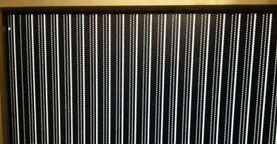

What I meant is how I'm to test whether 3D is working (if at all) as intended or not. 3D accel games was not exactly my era of active gaming )
Right now, i have successfully booted with 32KB vga BIOS you provided. Now I get extra BIOS VGA message before main BIOS boot.
UPD:
64KB is a no go. And it halts the boot process, so I can't reflash through autoexec.
    169.16 KiB
    1108 views
    75.97 KiB
    1111 views

Ah, shame the 64KB ROM is a no go. Thanks for testing that.
When you've reflashed the working ROM -
First run setup.exe in this archive to install this XGI driver.
https://ufile.io/c4hix8ew
Then check with dxdiag to see if Direct3D says if D3D acceleration is available or not. or install UT99.
