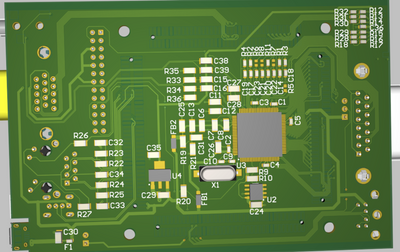

I'm already quite desperate, today I made WeeCee revision 0.4. Unfortunately the BIOS does not see the SD card. I have rechecked the paths and everything is fine. Does anyone have any experience of what this could be? According to the schematic there should be nothing wrong. Thank you for any help.

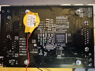

It's obviously not a BIOS setting. I set it up the same way as with version 0.3, which I have at home, and it works great. But version 0.4 refuses the SD Card. I still have the SOM304RD52VINE1. I've checked the paths, resistors and haven't found a problem. I kept with https://workspace.circuitmaker.com/Projects/D … /rasteri/weeCee including the revision of the components.

Vridek wrote on 2023-01-14, 13:48:
You've checked continuity from the SD card slot pins to the rest of the circuit, but have you checked continuity between the pins? Have you ruled out a tiny solder ball between pins that sits unseen under the component?
You put the wrong pulldowns and pullups in the spots you should had left disconnected. R10 and R19 should be NC, so you shouldn't have populated those.

I made adjustments to the components according to revision 0.4. WeeCee is already running great.
