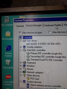

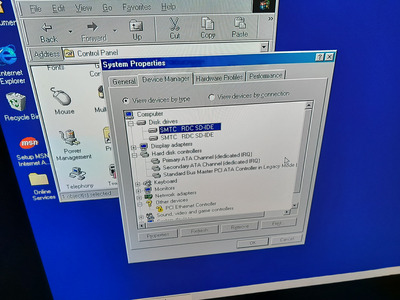

Reply 801 of 912, by Paul_V
I asked a colleague at work to install WIN98 to an SD card on ebox-3330, which has a Vortex86DX2 onboard.
Works out of the box with "Legacy IDE" and SD card options enabled.
Then I was sent a backup of it's BIOS, removed original VGA ROM (DX2 has it's own integrated VGA) and inserted Volari ROM instead.
Flashed it to my Vorted86DX board and got the same Code10 issue.
Which rose more questions than answers...
I have a suspicion that unused slave device pins on primary IDE channel may need to be disabled\shunted manually.
But I cannot compare the circuitry, since I don't own ebox-3330 or similar DX2 based board with SD slot.
Reply 802 of 912, by Duffman
@Paul_V
That screenshot shows that it's at least possible to get Win98 to work properly with an SD card.
I'm just hoping I can achieve something similar like that with just a registry hack or something.

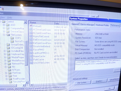

Reply 805 of 912, by Duffman
I went looking through IOS.VXD using IDA Pro disassembler and found something that might be useful for us.
There is a 'ForcePMIO' binary registry key that could solve our problem. There is an inverse 'ForceRMIO' key as well that isn't useful for us, but to check it worked in a VM when I tested it though.
From what I gather, the key belongs in
HKLM\System\CurrentControlSet\Control\FileSystem
and set to 1 if we want to use it.
I've given it a try and my initial impression feels like it's running snappier, but I need a tool that works in win98 to actually check if it's doing anything.
Any suggestions?

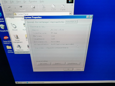

Reply 806 of 912, by Mu0n
I tried adding that binary key, value 01, had to create the key since it wasn't present.
Tried copying a multi-gig file through a network shared (on my weeCee win98se, sent from modern win10 machine) and the same behavior happens. Goes up to 1MB/s for a sec or two, throttles back down to 0 for several seconds, rinse repeat.
see attached image to see if I messed up the binary key in the registry.
I haven't followed the discussions in the last 10 pages much, I assume we're still talking about the weeCee and not another variant of Vortex86 SOM?
1Bit Fever Dreams: https://www.youtube.com/channel/UC9YYXWX1SxBhh1YB-feIPPw
DOS Fever Dreams: https://www.youtube.com/channel/UCIUn0Dp6PM8DBTF-5g0nvcw
Reply 807 of 912, by Duffman
I figured it wasn't actually working, but I don't have anything installed to measure if it was making a difference.
I'll have a look through IOS.VXD again, maybe there's a way to force ESDI_506.PDR to initialize hidden in there.
What tool are you using to measure MB/s?

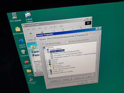

@rasteri @Nachtrave @Muon @Paul_V
So I did some hacks to rloew's IOS.VXD and ESDI_506.PDR and I've gotten rid of the yellow exclamation mark in device manager.
1.3 MiB
1783 views
Still not sure if these hacked files are actually working though, can you guys do some testing to check?

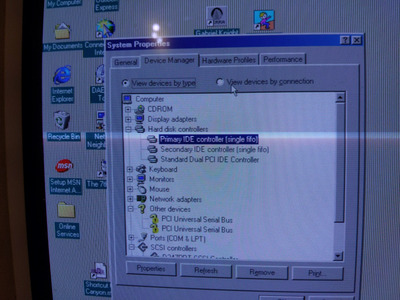

Reply 811 of 912, by Mu0n
Duffman wrote on 2023-05-19, 10:26:
@rasteri @Nachtrave @Muon @Paul_V […]
Would you kindly offer instructions in how to use the files? I may have had the wrong assumptions.
I see:
-install.bat
-installd.bat
-installw.bat
-patchpci.exe
I assumed I had to use installw.bat but I got:
"TBPLUS WINDOWS PATCHES ALREADY APPLIED - RUN UNINSTW TO REMOVE"
which is strange, because I've only run it that one time just now.
I then ran uninst
then ran install c:\windows
then rebooted
I no longer have the exclamation point in hard disk devices
testing a large 1 GB file transfer still does the slowdown thing. After a good 4 minutes of leaving it to oscillate, it estimates the total transfer at 30 mins, which is insanely long for this - so same behavior as before, sadly.
Reply 812 of 912, by Duffman
rloew wrote a readme.txt that explains it all.
-install.bat - install both drivers.
-installd.bat - install DOS drivers only.
-installw.bat - install windows drivers only.
-patchpci.exe - PCI.VXD patch for VIA controllers.
OK, now I know this hack doesn't actually work, thanks for testing.
Since it's broken you can uninstall.

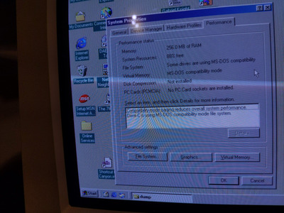

Reply 813 of 912, by Duffman
Success with the NT4 SP6 atapi driver?
1.11 MiB
1689 views
1.65 MiB
1689 views
Strangely it's feeling slower than the real mode driver, I sould do a fresh 98SE install in case I've broken it.
NT4 SP6 atapi driver attached.
To install place ATAPI.MPD into C:\WINDOWS\SYSTEM\IOSUBSYS
Then with regedit search for any occurrence of ESDI_506.PDR and replace it with ATAPI.MPD and then restart.

Reply 814 of 912, by Mu0n
ok, I tried it and eesh, I confirm it feels very slow.
The whole boot and login process feels much slower.
Copying files over the network from a modern PC takes ages before a speed is shown and it's up to around 177k/s instead of the usual 1000k/s peaks I got from before. To top it off, I think it still throttles down and halts for a few seconds at a time, just like before!
once the whole transfer time estimation shows up, it's 4 hours instead of 30 mins!
wild bonus: I also get a D: that's a direct copy of my C:, same files, capacity, everything.....

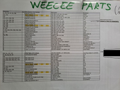

Reply 816 of 912, by Windows98_guy
Can someone please confirm the list of parts for the WeeCee board revision 0.3 (the original from Rasteri that you can get from PCBWay)?
I like to confirm i have all the correct parts before moving on with troubleshooting my WeeCee.
I've attached the picture of the parts lists i downloaded from PCBWay - i only added a few comments, where needed.
Reply 817 of 912, by Duffman
I think you're all good.
You can always ask here if you run into trouble with it.

Reply 818 of 912, by Vridek
Windows98_guy wrote on 2023-06-03, 09:15:
So use CS4237B-KQ instead of CS4237B-JQ. Do not use 24LC04BT/SN EEPROM... I'm having a problem with it and it says on flash that it has insufficient memory (4kB is probably not enough). Before that 24LC16B/SN was used. What do you want to help with at WeeCee?
Reply 819 of 912, by Windows98_guy
Vridek wrote on 2023-06-04, 17:53:
Ok, so I checked the sound chip - it is a CS4237B-KQ, so that's fine, I guess the list is incorrect and I didn't even noticed it. I used 24LC16B/SN for EEPROM, not 24LC04BT/SN.
The biggest problem that I have at the moment is that my WeeCee doesn't detect any microSD cards. Adjusting the boot options in the BIOS to "boot from SD card" doesn't seem to work. I'm guessing I didn't solder it properly, but I already tried to reflow solder on it twice. Maybe I didn't properly solder the pins of the SOM304 module?
