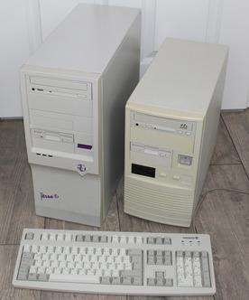

With 8 years I discoverd my first computer contact, Dads PET2001. After Pong, VCS, C64, Amiga, ST, SNES and MD came nothing for a long time, but 1996 I bought my first own PC in a german electrical market.
It was an AT with a Pentium 150, this one and the marked monitor:
398.52 KiB
1022 views
I own the catalog since this time, you can DL a complete scan here: https://filehorst.de/d/dJkhcqGg
With no expirience I had a lot of trouble with this thing. I´ve got a new CD-Rom, HDD and only with another mainboard the PC ran smoothly. I sold him after the Pentium II was released.

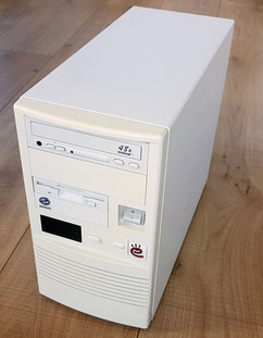

In 2019, by chance and without looking for it, I got the same case:
366.72 KiB
1022 views
The condition is not so good with yellowing, rust and scratches.

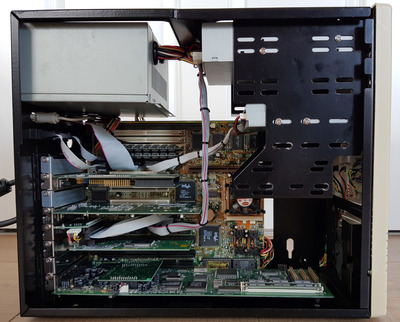

Over time I have collected some hardware. The goal is NOT to rebuild it 1:1, but close, just as if you had more money back then 😁
Config plan:
this Network case - only cleaning, rust preparation , no new paint - and some gentle retrobright (only sun)
Pentium 150@ 166 or P166mmx (current P233mmx)
Azza PT-5IV = Sockel 7 AT Mainboard with Intel VX chipset, 4x ISA and USB
32 or 64MB FPM, EDO or SDRAM (I will test it)
Matrox Mystique with 2+2 RAM
Diamond Monster
AWE32 + RAM + Wavetable or a AWE64 Glod
no HDD, only CF cards
CD-Rom
Windows 95b

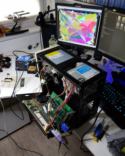

Yesterday I start testing the HW stability. For a simple way with a faster CPU and Win98se.
First fit:

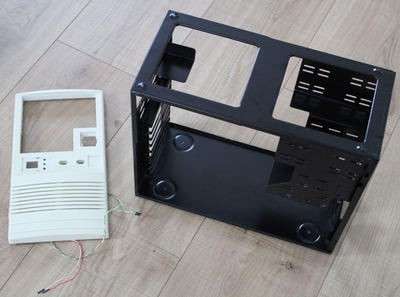

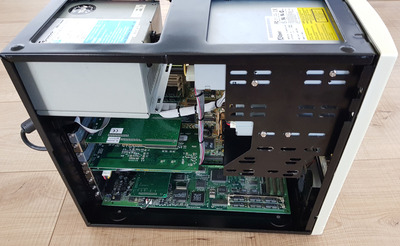

The last few days I tested the hardware and disassembled the PC for cleaning:
474.19 KiB
907 views

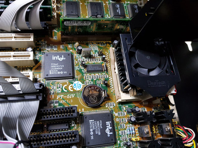

The motherboard is an Azza PT-5IV - never heard of 😁
I have the manual
Azza PT-5IV.pdf
254.86 KiB
10 downloads
but I don't know if there is a newer or better bios file. Currently it runs with the bios from 02.09.96 - maybe someone has info for me?
It has nice specs, but for me as a cable nazi the central connectors on the mainboard are pure horror - I will try my best....
vae victis!

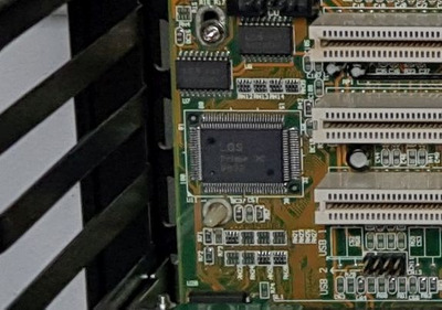

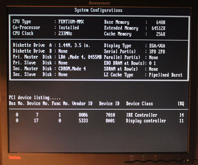

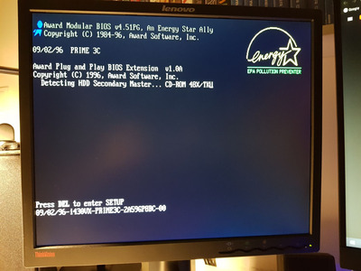

Reply 4 of 30, by vad4r
Deksor wrote on 2021-05-18, 21:41:
Latest bios is from 1997 http://www.win3x.org/uh19/motherboard/show/7199
Make sure to pick the right the one that matches your super IO chip.
whooohoo
Thank you very much 😀
My board hast the Prime 3C chip:
161.32 KiB
881 views
55.31 KiB
881 views

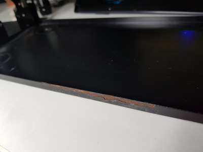

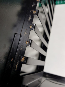

About the case:
Found some rust:
129.21 KiB
881 views
and a half screw:
185.25 KiB
881 views

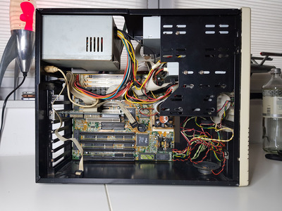

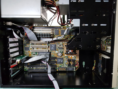

Reply 6 of 30, by vad4r

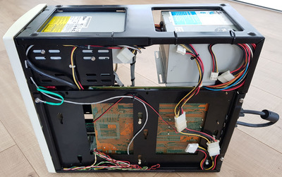

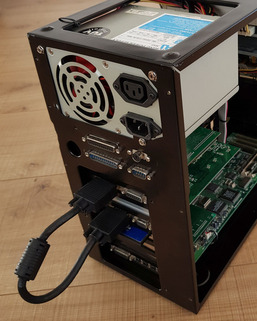

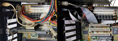

cable war - I think it´s easier to change the mainboard 🙁
1.27 MiB
837 views
The original cables were all yellowed. They were replaced and shortened.
668.4 KiB
837 views
WIP:
1.71 MiB
837 views
vae victis!
Reply 7 of 30, by vad4r

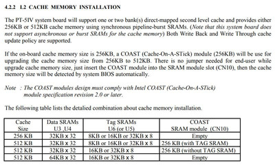

The Mainboard has a PBSRAM Slot for synchronous pipeline-burst SRAM Module. A 256kb module double the cache.
107.35 KiB
814 views
Is it worth buying such a module?
On Ebay Germany I found these offer:
https://www.ebay.de/itm/284224830003?hash=ite … W4AAOSw-a9gVDTA
https://www.ebay.de/itm/274725467818?hash=ite … h4AAOSwI7lgVDxB
https://www.ebay.de/itm/284221683000?hash=ite … n8AAOSwjIpgUHnM
https://www.ebay.de/itm/274722102071?hash=ite … bgAAOSwuZZgUHfG
https://www.ebay.de/itm/274725479096?hash=ite … sAAAOSw2ndgVEIu
Which would be the right one?
vae victis!
Reply 9 of 30, by vad4r
evasive wrote on 2021-05-19, 12:04:
Some info on COAST modules here:
Neet help finding a PB COAST module for 430FX
(We are interested in a good resolution picture of the mainboard for UH19 btw).
Thx for the link, but for picture from the board we are too late....

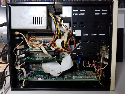

Currently installed:
CPU: Intel Pentium 166MMX
Case: Network AT Mini Tower
Mainboard: Azza PT-5IV
RAM: 2x 32MB EDORAM
Grafik 1: Matrox Mystique mit 2+2 RAM
Grafik 2: Diamond Monster 3D
NIC: 3Com EtherLink III ISA
Sound 1: Creative Sound Blaster AWE32 (CT2760) + RAM
Sound 2: Hizon DB333 Wavetable
HDD: 4GB CF-Card
ODD: Aopen CD948E
PSU: Seasonic SSA-200G with new fan Xilence XF037
OS: Win98SE

Reply 10 of 30, by chrismeyer6
That is some serious cable management goodness right there. You rarely see AT systems that clean looking since most of the cases are cramped and just the rats nest of cables off an AT board. Bravo my friend.

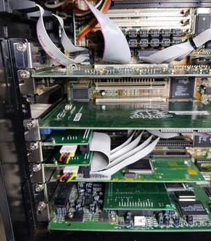

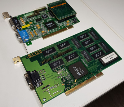

But the last days I had a lot of problems with this built. The Mystique died 🙁 🙁 and the PC sometimes would not start.
After a long search I found the problem: the fuse in the power supply had contact problems.
1.09 MiB
573 views
The Mystique was replaced by a Elsa Winner 3000
991.73 KiB
573 views
After the computer was working properly again, it got another new component: a fast 256kb Cache module for the PBSRAM Slot - and I change the CPU Cooler, the new one is temperature controlled
1.63 MiB
573 views

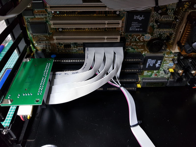

The Diamond Monster 3D was replaced by a Orchid Righteous 3D and I build a new IDE cable for two CF adapter:
112.32 KiB
573 views
1.56 MiB
573 views
The last free Slot panel is for the USB connectors, I´m looking for them right now......
