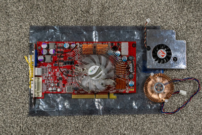

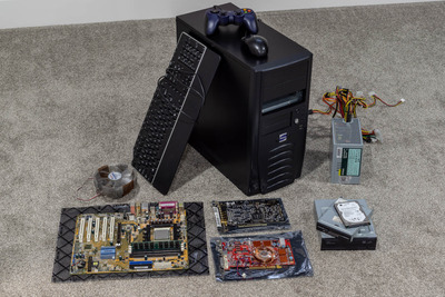

Unfortunately I discovered that my Radeon 9700 was artifacting (probably decaying bumps on the BGA memory). As a replacement, I bought a Radeon 9800 Pro + Sound Blaster 2 ZS from a local seller for $40. The remainder of the parts are things I had lying around already:

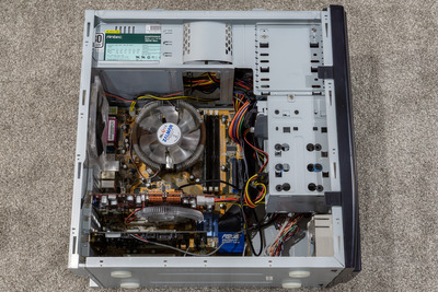

CPU: Athlon 64 2800+ 1.8GHz socket 754 with Zalman CNPS7500-AlCu blue LED cooler
MB: Asus K8N (nForce 3) with single 512MB stick of DDR400
VGA: ATI Radeon 9800 Pro 256MB AGP8x with AliExpress cooler (as seen on Phil's Computer Lab)
Sound: Creative Sound Blaster Audigy 2ZS PCI

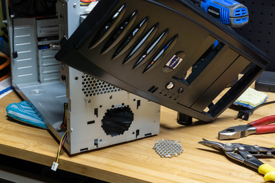

Case: Antec SLK 1600 with front intake grill cut out and blue LED case fans
Storage: Seagate 40GB 5400RPM 2.5" SATA (taken from a fat YLOD Playstation 3)
Monitor: Dell Ultrasharp 2007FP 1600x1200 DVI
Gamepad: Logitech F-310 running in DirectInput mode
OS: Windows Millennium Edition (I know it gets a bad rap but it's been 100% stable in this build!!)
