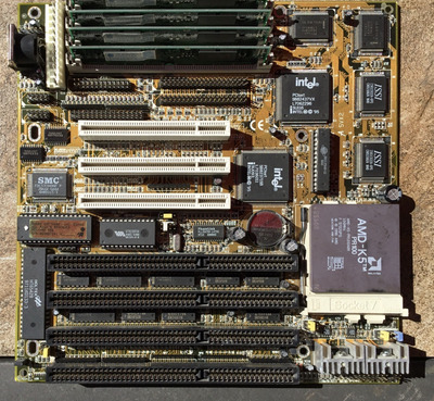

Reply 25 of 77, by Anonymous Coward
430VX doesn't support UDMA33, but it does support a 16MB/sec DMA mode which is still way better than PIO. For drives of the period it really wasn't much a of a big deal. Same with the 64MB cacheable limit of the FX and VX. These boards were basically obsolete by the time more than 64MB was needed.
Reply 26 of 77, by Intel486dx33
Anonymous Coward wrote on 2021-08-10, 07:52:
Yes, Its not the fastest Win95 computer just a period correct build. For most DOS games I found the Pentium 75 is fast enough.
This computer will have 128mb ram, 512kb cache, Pentium 200mmx, and 7.2gb IDE hard drive.
I do have a 430tx board but it is dated 1998. And I have these VX boards just laying around so I wanted to do
Something with them.
I realize there are always limitations in everything we do so I just want to make the best of this motherboard build.
FIC PT-2006 Motherboard manual:
https://stason.org/TULARC/pc/motherboards/F/F … um-PT-2006.html

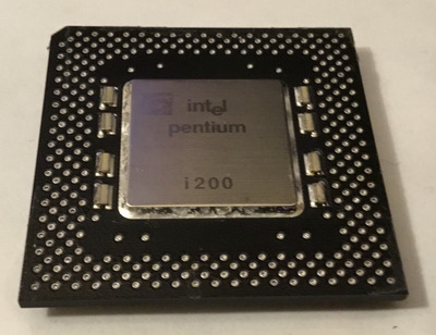

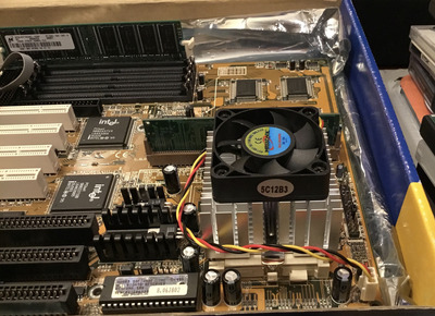

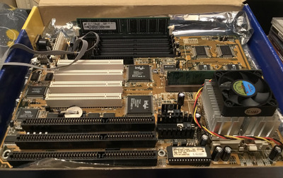

Reply 27 of 77, by Intel486dx33

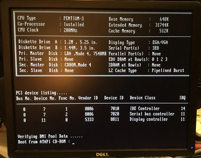

Okay, I have this setup with the Intel Pentium MMX-200mhz. CPU.
128mb of PC-133u ram
512kb system cache.
And a BIG CPU Cooler.
Should be a pretty good Win95 computer. Defiantly on the High end for its time.
This motherboard has 4 PCI slots as opposed to the other motherboard which only has 3 PCI slots.
The extra PCI slot will come in handy. 3 ISA slots is enough for testing ISA cards.
Mainly ISA sound cards. All the other cards will be PCI.

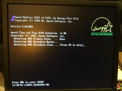

Reply 35 of 77, by Intel486dx33
Easy WIn95 build was NOT so easy after all.
I guess is you want an easy build use a strip down motherboard like this Acorp motherboard with NO USB or PS/2 port.

Reply 37 of 77, by Intel486dx33
Caluser2000 wrote on 2021-08-12, 12:01:
Intel486dx33 wrote on 2021-08-12, 04:46:
Not it's not. That's why most folk got them with the OS already installed and set up. Far too many options wrt hardware selection and finding the correct divers etc, etc ,etc.....
Then of course the constant rebooting when setting up hardware/software...
Actually, with the cards I selected every thing installs great with supplied driver included in WIn95b install CD.
Only have to add Win95 Service pack 1 and USB driver support if you want USB to work.
I guess USB was more a Win98 thing.
This build is coming along great almost done.

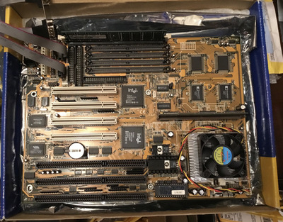

Reply 39 of 77, by Intel486dx33
Here is what I have so far and I have everything working.
I just need to clean everything up and do some cable management.
