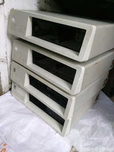

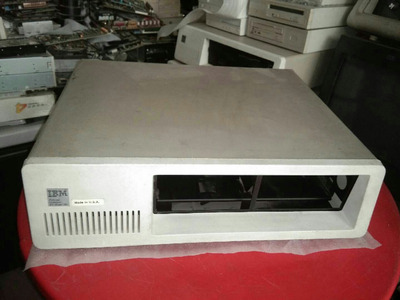

So i begin to buy my parts, but i want something special. In a Mac community people are getting old Macintosh cases or G4 or G5 Mac Pro cases and modding it. But PC doesn't have much iconic look that represent the PC line - BUT there is only one memorable design and that is old IBM cases, which i think they are still beautiful even today.
I did search and i found some old computer house/storage that have many of these machines

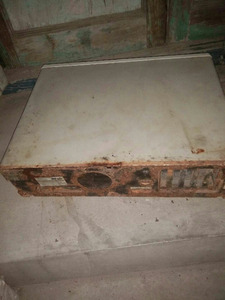

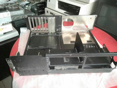

I contact the seller and ask if i can get the case. Of course Chinese seller figure out i am foreigner so he put the price high. But i was persistent and told him i want only case.
First case he offered was this: 😀

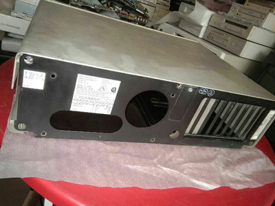

Reply 2 of 18, by dank0
Terrible, but he knows i saw the rest of his stock and he offered me this beauty:

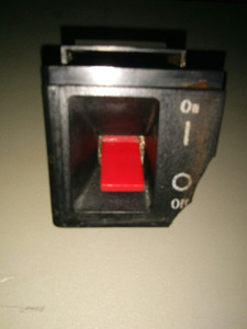

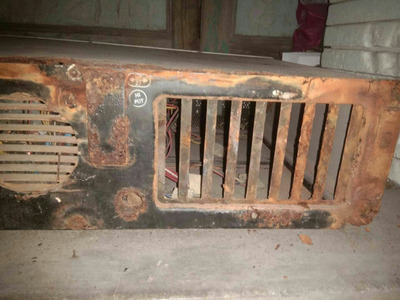

Reply 3 of 18, by dank0

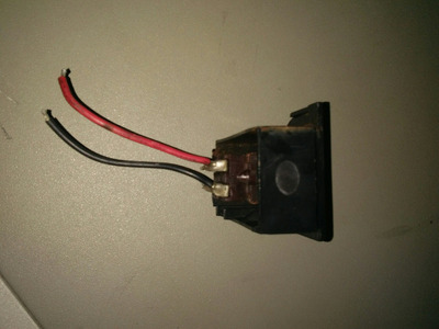

the only problem was, it didnt have the power supply (which i dont care tham much, but i really want the big Power Switch. It is soooo iconic and cool design. And again he didnt want to take apart some other power supply units so he sent me this:
    194.49 KiB
    1310 views
    687.28 KiB
    1310 views
AMD K6-II 500, Nvidia TNT2 AGP, 256 MB RAM
•• WANTED: ROLAND SCP-55 ••
Reply 4 of 18, by dank0
I was just shaking the head, but it is better to get something than nothing. because i have skills 😀 I have 3D printer and i am 3D modeler for many years so I would try to print it out and try to recycle parts that are not destroyed. Here is the result:

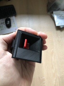

I get the case without any Floppy drives or HDD it looks like this(check the attachment image) before my 3D print and drives solution. I decided to use Gotek as a floppy drive replacement, I also will use CD drive for CD games and the big hole i will fill with led panel (power and HDD)
    167.36 KiB
    1179 views
Reply 10 of 18, by dank0

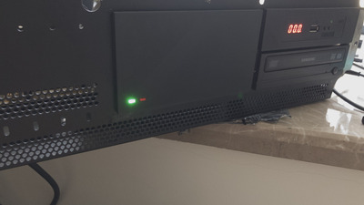

And here is my result, I 3D printed the 2.5 Floppy bracket for gotek drive and the big HDD cover with two led light positions on the left bottom corner. I think it looks good. But i will print new version of the HDD cover with black reset button on the right side.. I was also thinking to put inside raspberry pi with mt32pi system and put the display in the center of the HDD cover. I will see, maybe it will look cheesy. What you guys think?

Quite like that rusty old first case. Could make a "ratrod" kind of build. I wouldn't pay more then a token amount for it though.
Your build is coming along real nice as well, kind of funny seeing a CD drive in a XT case.
I agree having the MT-32 Display somewhere is important and if its located inside the case then your idea makes the most sense.
Maybe you could do a traditional 1/2 height HDD plate and a second "custom" plate for the MT32 so it's kind of original but kind of not?
