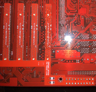

Reply 147 of 177, by H3nrik V!
Sphere478 wrote on 2022-12-14, 19:44:
FREEWAY DESIGN FW Ti5VGF 1 3 3 V Adapter pi.0.zipI'm gonna order this. confidence is high. graduating to pi.0
It seems that a lot of nets are unrouted in that zip???
Also it's visible on your last image, where ratsnests are visible?
Reply 148 of 177, by Sphere478
It’s okay. Those are on purpose. 😀
3.3v vsb is on purpose
3.3v/5v hybrid pins are no longer routed on this design. That layer is now used for ground pins

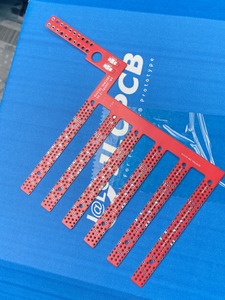

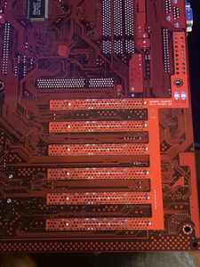

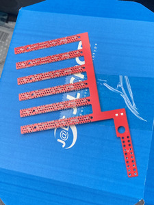

Reply 149 of 177, by Sphere478
They arrived!!
1.89 MiB
1222 views
1.69 MiB
1222 views
Fitment looks good. Made some minor adjustments to previous upload. Previous post is now updated. I want this to be 100% perfect for this rare motherboard so I’ll probably order another batch to satisfy my ocd. 😀 The main problem was that the freeway logo was backwards 🤣

Reply 151 of 177, by Sphere478
Freaking beautiful!
Will solder on soon 😀
Sphere's PCB projects.
Reply 152 of 177, by Sphere478

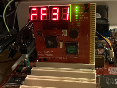

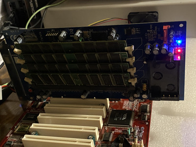

Well, looks like a success!

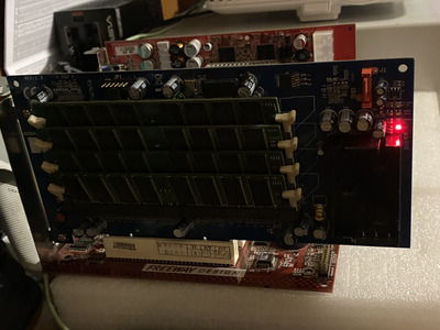

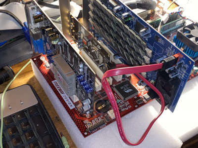

In the following images you’ll see results in bottom slot, and in top slot.
The top slot is currently the only one soldered up. The rest are free floating. Wanted to test before finishing up. 😀
A note, be sure to push down on the pcb near where you are soldering. Otherwise the bodge board will float.
Also, I put kapton tape over the bulk capacitor vias. (Not pictured)

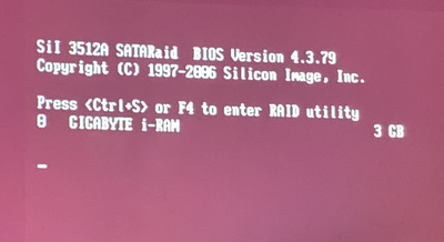

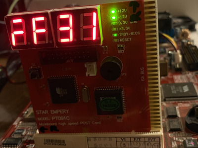

Reply 153 of 177, by Sphere478
Gigabyte iRam is working!
The 3.3v aux light on the diag card I assume will light if I hook up 3.3v vsb but I left it unconnected.
I would imagine that the iRam might actually use that, so I may connect it later.

Reply 157 of 177, by Kahenraz
What do you use the iRAM for? As a swap drive?
I could never find a desirable use case for one of these on modern systems. At 4GB max, I would rather use that slot for an ATA133 with a fast UDMA card or a SATA adapter with a large SSD.
I think they were more desirable way back when consumer HDDs were the norm and SSDs weren't really a thing.
Reply 158 of 177, by Sphere478
It’s for a swap file. Since using a ssd, can’t use swap on the ssd, so put it on the ram of the iRam.
I mean, I have enough ram that it doesn’t need a swap file, but you know, having fun, building cool crazy stuff. 😀
