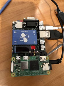

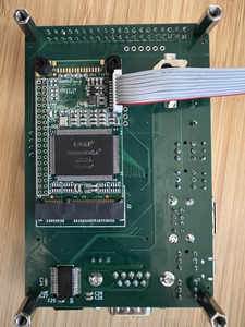

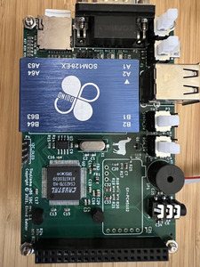

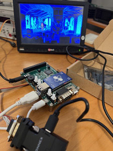

I received one of Eivind's kits last week and built it on Sunday.
The build went pretty smooth and with the great instructions on github I had Indiana Jones and the Fate of Atlantis running within a couple hours.
508.52 KiB
1251 views
Complete board top
500.19 KiB
1251 views
Complete board bottom

1251 views
First game running
Adding the MT32-pi was a bit harder than expected.
First I thought I could directly plug my Pi Zero 2 into the 40-pin connector. Took me a while until I realized that I had it upside down. My Pi Zero 2 came with the headers pre-soldered, so they were on the wrong side.
And desoldering those headers also took a while and I cracked a SD card in the process. I was almost convinced I broke the Pi during desoldering when it didn't boot. Especially these days I'm happy that it was just the SD card.

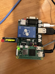

Next mistake was to install the display in the wrong way.
422.74 KiB
1251 views
Connected the display in wrong orientation

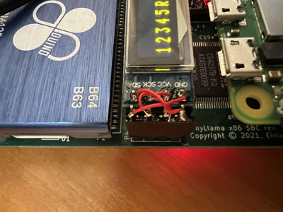

- I need to do something about the display sticking out on the side
Did you solder the display onto the board directly? I would suggest using 4 Dupont wires instead, and mounting the display in a case of some sort (btw, take a look at my example case on Github.
I did solder a female dupont header to the display that attaches to the pins on the board.
Thanks for sharing the case design.
Going with the solution until I have some kind of case: glued another 4 pin female connector to the one on the display board and then soldered wires to the pins.
