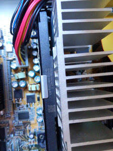

Mainboard

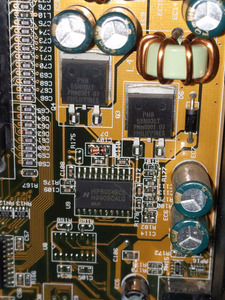

I was looking for mainboards that gave me lots of options and found a Chaintech 6BTM0 (Intel 440BX chipset) which has three ISA, four PCI and an AGP slot as well as an onboard USB controller. I didn't know about the Slot 1 architecture before but found it quite charming - being able to switch CPUs without going through the trouble of applying thermal paste and mounting fans. With the overclocking options available in the BIOS (which has all the features one could wish for) it's possible to run CPUs with clock speeds between 133Mhz and > 1Ghz.
1.47 MiB
3817 views
The voltage regulator at U9 needed for Intel Coppermine support

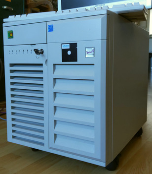

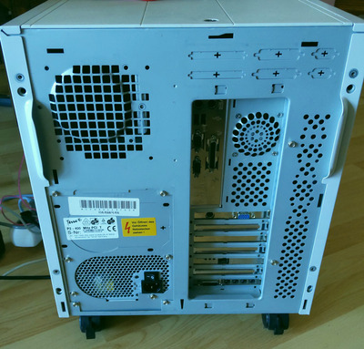

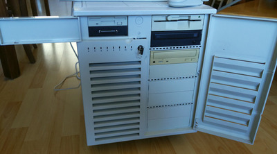

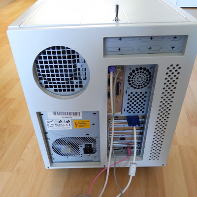

The case
After ordering the mainboard it was time to look for a suitable case - what turned out to not be that easy. New PC cases are either ugly (seems like everyone wants a Death Star with Christmas lights as a computer these days), didn't have enough external drive bays or were sold out. Used cases were mostly ugly in another way (having "this computer runs Windows XP" written all over it), too old (supporting only AT mainboards) or way too expensive.
Finally I came across a good deal for an old server case. Was it too big? Maybe.... But it had swinging doors, two 3.5" external drive bays, eight 5.25" external drive bays, lots of non-blue LEDs, an important looking lock mechanism and *wheels*!
So I just could not resist....
396.72 KiB
3817 views
It just looks so nice...

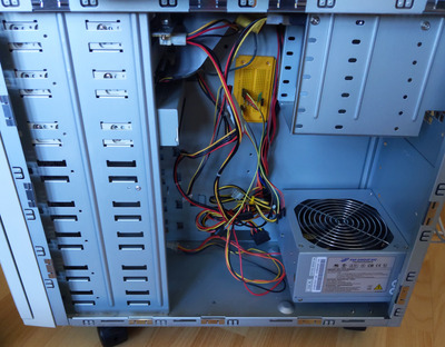

It came with an ATX power supply that had enough juice and was silent enough for me (no -5V but I have no need for this as of now). It also came with a beefy PC speaker and 3 fans powered by Molex HDD-Connectors that could chop off your fingers... I put those into the spare bin. Finally an assortment of drive rails and brackets was included.
Reply 1 of 32, by Doornkaat
Hell yeah! I have a very similar case (if not the same!) in much worse condition. Does yours have the plastic cover still on the back? I'm not even 100% sure if there's supposed to be one; mine doesn't have one but there appear to be mounting holes for one.
Reply 2 of 32, by GrafWasili
Doornkaat wrote on 2022-03-09, 09:10:
Cool, maybe you can make it pretty again some day 😀
Indeed it still has the back cover, but it's missing all but one of the hooks that attach it to the case, so it's not on there right now 🙁
The second lock at the rear end of the top panel is for preventing it's removal and thus access to the side panels. I can post a picture later!

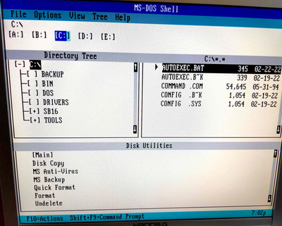

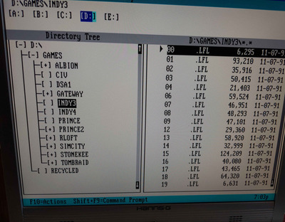

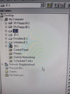

I also tossed in an old 20GB IDE spinning disk which again I formatted on my main PC as follows:
||------8GB-extended-DOS-partition------------||-----12GB-primary-DOS-partition-(FAT32)----||
||-2GB-FAT16-logic-partition-|-6GB-unused-----||
...ending up with an extra 2GB data partition for DOS-usage and an extra 8GB data partition for windows. The only oddity is that there's another inaccessible drive of 12GB size shown in Windows Explorer as drive D: 🤔
1.02 MiB
3786 views
Drives as shown in DOSSHELL

Drives as shown in Windows Explorer

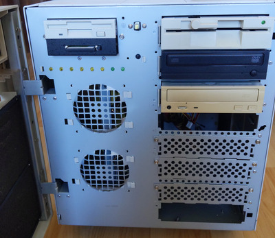

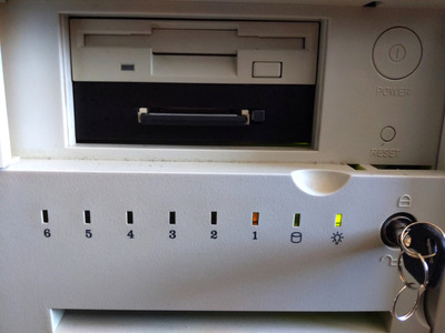

For optical media I installed an old school 4x CD-ROM drive and a modern-ish DVD reader from my parts bin.
To speed up the hard drives and free up IDE-ports for future expansions I later got a Promise Ultra-133 IDE-Controller and some quality (80 wire) slightly overlength (60cm) IDE ribbon cables. After fiddling around with the right BIOS settings it booted up nicely.
For the sake of completeness I also had to buy a 5.25" floppy drive. Boy are these things expensive now. I did some cleaning and lubrication on the one I got before hooking it up and fortunately it seems to run without a flaw.
The fact that all 5.25" drives are inserted on rails, makes it easier to swap their position later for aesthetic or cable length reasons....
757.54 KiB
3786 views
All the drives
767.69 KiB
3786 views
Behind the scenes

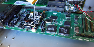

I already had a Matrox VGA card and a TFT-Monitor for testing the mainboard and getting started. But to get my dream setup going I also ordered a Vodoo 3000 AGP card and a CT2230 Soundblaster16 that I identified - again with the help of this forum - as a suitable option for all retro gaming sound requirements.
To treat my ears with some quality MIDI sound I also got the X2GS waveblaster daughter board from serdashop. Probably spend an hour running >playmid monkey.mid over and over again 😀
939.67 KiB
3772 views

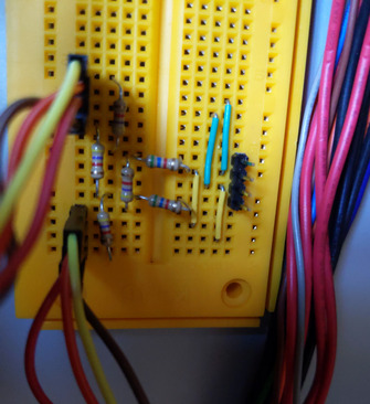

I also wanted to connect both of my optical drives to the sound blaster so I rigged up the simple passive mixing circuit which was linked somewhere here. It worked but unfortunately the noise level introduced by it was not worth it. I don't know if the circuit layout or the bread board is causing this or if it's a general flaw of the circuit...
633.3 KiB
3772 views
Passive CD audio mixing circuit
In general I realized the noise level of the soundblaster board is not too convincing. CD-Audio has some noise, but wave audio seems to be very noisy, for example the Windows 95 sounds. I don't know could this be a failure of the board? Or is it just the low quality of wave files used at this time? I need to do some more testing there....
1.07 MiB
3772 views
The drive & power supply compartment

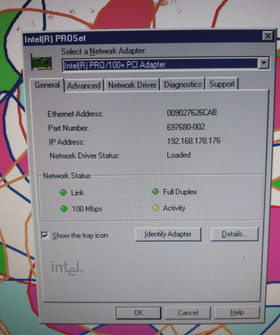

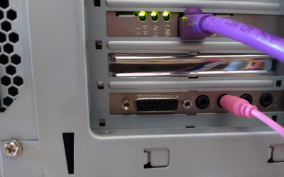

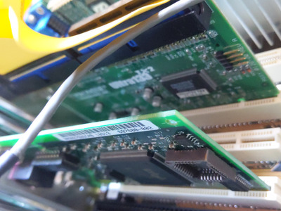

Connecting to the Interwebs
To connect our new pet to the internet (so i don't have to shut it down for every download or try to squeeze it onto a floppy disk - and of cause also just for fun) I added a Intel Pro 1oo+ Network card which boosts more LEDs both physical and virtual!
566.84 KiB
3766 views
Green across the board
1.91 MiB
3766 views
First contact
844.49 KiB
3766 views
PCI expansion slots

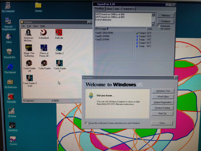

Software
Installing all the required drivers, updates as well as DirectX and some handy tools in Windwos 95 probably was the most time consuming part of the build. I did manage to get everything working - despite the onboard USB-Controller which still remains with the dreaded exclamation mark in device manager 😩
But now for some games. I installed and tried what I had lying around on floppy or CD. Every game worked flawlessly with optimal sound and graphics options. For Indy 3 I needed to use the at-slow tool to slow down the CPU.
The only exception was American McGee's Alice (based on Quake3 engine). With highest details at 1024x768 resolution it was skipping a lot of frames.
    1.43 MiB
    3759 views
    1.04 MiB
    3759 views
    Please appreciate my MS Paint skills

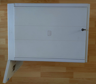

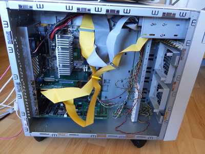

Reply 18 of 32, by GrafWasili
Thanks for the appreciative comments.
As promised here are some pictures from the back with and without the cover. You might see it's just dangling there because of the missing plastic hooks.
817.77 KiB
3302 views
817.52 KiB
3302 views
471.99 KiB
3302 views
A look at the back shows there's room for a second PSU and there's also a sticker on the back saying P2 400 Mhz.

Reply 19 of 32, by Doornkaat
GrafWasili wrote on 2022-03-19, 12:05:
Thanks for the appreciative comments. […]
