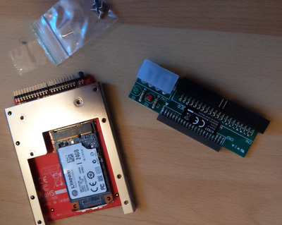

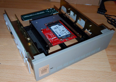

Update time!
Part 1:
Introducing the Front Panel mSATA SSD Holder
I found this nice hard disk bay adapter with front panel and with some more adapters I now have a SSD attached to the Ultra133 IDE controller. The front panel also has a red LED but none of the adapters used have a built-in connector for one. Another detail to take care of at a later time...
819.76 KiB
588 views
950.49 KiB
588 views
In case you didn't know I do love adapters and my true purpose is collecting all of them! (if there isn't already a dedicated adapter appreciation thread on vogons there should be one...)

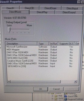

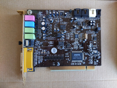

Part 2:
The Sound of the Future
So after chinny22 recommended installing a second sound card I tried to find may way through the jungle that is hardware accelerated 3D audio. Since this machine is trying to be a jack of all trades anyway I looked into Sensaura based cards which implement EAX as well as A3D at least up to a certain revision.
When I discovered the Terratec DMX Xfire 1024 with its huge list of features and its very low market price the decision was easy.
1.63 MiB
559 views

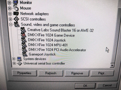

What was not so easy was making it play along nice with the SB16 on Windows 95. After my first foolish attempts, trying to install drivers from an image of the retail driver CD, I ended up with two sound cards not working.
For future reference here's what worked for me:
- starting point: both cards in their slot, but removed in Windows Hardware Manager, Xfire drivers not installed/uninstalled, skip installing new hardware after boot
- setting IRQ and DMAs for Soundblaster to reserved/legacy in BIOS
- unpacking drivers for Xfire from their website: http://terratec.ultron.info/Audio/DMXXfire/Up … .06.00.2885.exe (nice move to still have drivers available after 20 years)
- start hardware discovery via Control Panel -> Add Hardware and point to directory with unpacked drivers
- disable Xfire Game Device (that's the cards OPL/SB emulation) in Hardware Manager, manually set IRQ and DMA for Sound Blaster in Hardware Manager
After another reboot and with a patch cable running from the SB16 line out to the Xfire line in + unmuting the Xfire line in in the mixer I got the setup I was aiming for - at least in Win95.
1.65 MiB
559 views
Much MIDI
1.5 MiB
559 views
Many Device
I still need to check out how far DOS support goes. It would be nice to use it for mixing CD audio with the line in from the SB16, so there won't be any need for repatching audio when switching from Windows. It also has two connectors for CD audio, so there wouldn't be any need for an additional mixer when using multiple optical drives. Thinking of it, it also has digital audio connectors, have to try these out as well...
The Xfire also adds another Waveblaster header but it's known to not work under DOS, so I'm not sure what card I would add there...
EDIT: Oh, I almost forgot: The Xfire has internal headers for all external in and outs, which means more front panel action 🥳

Is that an M2 SSD in a 2.5" interposer in a 3.5" adapter, mounted in a 5.25" bay? Wow, starting to see that you mean business about loving adapters! 🤣

Not quite correct. It's a mini-PCI SSD and there's also a 40 pin to 44 pin IDE adapter attached! 😜
chinny22 wrote on 2022-04-07, 08:40:
Man I hate adapters and try to keep things as native as possible, maybe we should meet up and I'll take say any DVI to DP cables you have and I'll give you the plastic adapters instead 😉
This is of cause not possible because I do not own any such cables! I simply have no need for them because I own every possible video adapter and converter..
