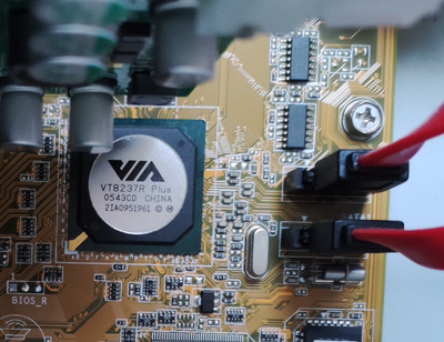

Joseph, how did you know the motherboard has VT8237R Plus southbridge? The manual speaks only of VT8237R and so does the text on the chip, at least on the image I googled. Even the CPU-Z image you posted shows only VT8237.
It obviously does have the Plus version since you are rocking modern SSD's with it, but how the heck did you find out that it does?
Reply 101 of 142, by bloodem
Sombrero wrote on 2022-08-18, 02:07:
It’s probably a matter of revision. This one certainly has the “Plus” south bridge.

Reply 102 of 142, by Joseph_Joestar
It's written on the chip. Here's a close up pic:
454.95 KiB
2310 views
I don't think CPU-Z is precise enough to distinguish between the different revisions of that southbridge. At least not in the Win9x compatible "Vintage Edition" which I'm using. Heck, that version couldn't even measure the frequency at which my memory is operating (DDR400).
If you mean how I knew that the Plus version would support SATA II and SATA III drives, it was stated in one of VIA's public announcements:
CHIP FIRM VIA issued a note to its customers telling them of problems with chipset support for hard drives using the Serial ATA II standard. It said that VT8237 and VT8237R chipsets don't provide forward compatibility for S-ATA II, which is important as hard drive makers are beginning to manufacture this type of drive. But Via is readying the release of VT8237R Plus, which will solve the problem.
I can't access the original article (link no longer active?) but here's a post on the HDDGuru forums which references it.
Reply 103 of 142, by Sombrero
Joseph_Joestar wrote on 2022-08-18, 04:52:
Alright so it is written on the chip, that explains it. I probably looked at a picture of an earlier revision like bloodem said.
No, I meant how you knew the motherboard had the plus version not knowing it was written on the chip, sorry if I was a bit unclear. I was just confused how you could tell it was VT8237R Plus and was wondering was there some other way to see it or did you x-ray the chip or something 😁

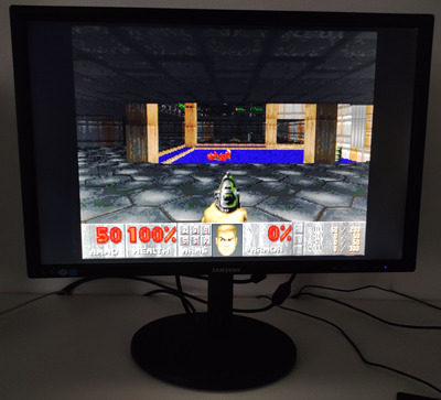

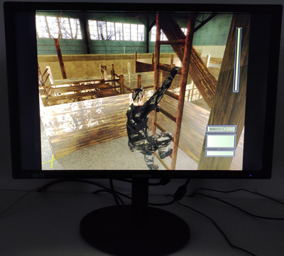

Got a new display for this build. It's a Samsung SyncMaster S24B420BW 24" LCD monitor with a native resolution of 1920x1200. This allows me to use the 1600x1200 resolution (with the 4:3 aspect ratio) in most Win9x games, and even some early WinXP titles as well. I do get black borders on the side of course, but the centered image is pixel perfect and looks excellent. As an example, here's Splinter Cell (slowly) running at 1600x1200 on this monitor:
472.3 KiB
1966 views
DOS games like Doom which use the 320x200 resolution get upscaled to 1920x1200 (a clean 6x scale on each axis) and then set to the 4:3 aspect ratio. This ends up looking fairly nice as well. Not sure how well it will come across in photos, but here's a pic:

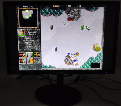

SVGA games from the DOS era running at 640x480 also seem to scale fine. Here's a photo of WarCraft 2 on this monitor:
372.29 KiB
1966 views

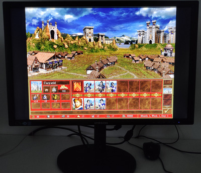

Lastly, Win9x games which run at a fixed 800x600 resolution (e.g. Heroes of Might and Magic 3) also seem to scale very well on this monitor:
661.64 KiB
1966 views
Again, I'm not sure how well this comes across in photos, but the end result looks quite nice to my eyes. Also, since I just got this monitor today, I haven't played around with all the image settings yet. It might be possible to get an even cleaner image with some additional tweaks.
Reply 108 of 142, by H3nrik V!
Anything "native resolution" and "clean scaling" doesn't need good pictures for me to know it's the best way to watch it. Congrats on your 1920x1200 monitor 😀
Reply 109 of 142, by Joseph_Joestar
H3nrik V! wrote on 2023-01-14, 14:44:
Cheers! 😀
I'm very happy with the monitor, especially since it was a fairly cheap second-hand purchase. Didn't expect that it would perform this well to be honest. I currently have it hooked up to this system via VGA and to my WinXP/7 rig using DVI. Turns out, this one monitor can cover all of my games from the 90s DOS era, over Win9x, all the way up to WinXP titles from 2009. Good stuff.

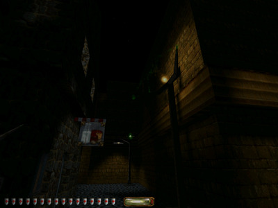

Thief II
This seems to be a later re-release, pressed on a single DVD instead of multiple CDs. It has a modernized installer which works without issues on WinXP and Win7, while still running fine under Win9x. This release is pre-patched to version 1.18.
