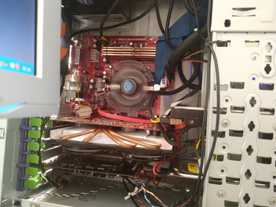

I initially started doing the benchmarks on a Pentium Dual Core E5800 build, but I now switched to an Athlon 64 build that I have in this other location.

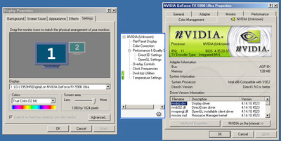

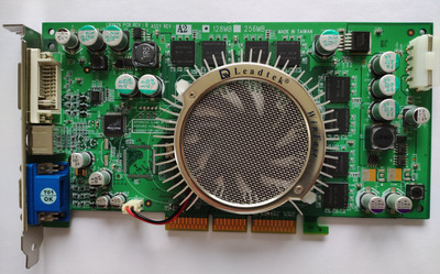

This Winfast A350XT board that I have here is a truly remarkable overclocker: I was able to push it to GeForce FX 5950 Ultra speeds and it can go even faster than that!
So, further down, you will also see benchmarks with the overclocked card. Please note that the GeForce FX 5950 Ultra has 256 MB of RAM, and that extra memory might actually matter for the 4x AA and 8x AA tests, so in these extreme circumstances the results might not reflect the performance of a true GeForce FX5950 Ultra.

MB: Asus A8V Deluxe
CPU: Athlon 64 "Venice" 3800+ 2.4 GHz OC @ 2.7 GHz (FSB225 x 12)
RAM: 1 GB DDR Single Channel
VGA: Leadtek Winfast A350XT GeForce FX 5900XT 128 MB (default clocks: 390 MHz Core / 700 MHz memory)
SOUND: Yamaha YMF724F-V

Leadtek Winfast A350XT GeForce FX 5900XT 128 MB OC @ 5950 Ultra speeds (475 MHz Core / 950 MHz memory)

Nice, clean build, enough powerfull for W98/ME. I build something similar, only based on nForce3 and with Turion CPU and Geforce 6800.
Cheers!
Out of curiosity, how has your experience with the 6800 been in terms of compatibility with Win9x games? I briefly tested a 6200 AGP with 77.72 drivers (that particular card couldn't take lower driver versions) and I encountered graphical oddities in certain games like Dino Crisis.
Reply 66 of 142, by Ydee
Yes, I read it before, but personally I'm still "under construction" - I wanted the strongest possible GPU with official drivers for W98SE because I have a dualboot with WXP.
If I run into problems with older games, I still have the FX5700 and GF4Ti4200 (like you) as backup. When I'm done, I'll start a thread here and share the experience.

My Leadtek GeForce FX 5900XT finally decided to show up. The card seems to be in excellent condition and the stock fan is quiet and efficient. I haven't done any detailed performance testing yet, but my preliminary results are a bit unusual. Quake 2 at 1280x960 is actually slightly slower than it was on my GeForce4 Ti4200. On that card I had 302 FPS, while I only have 292 FPS on the FX5900XT. This is also below what @bloodem had on his 5900XT. I'll have to investigate this further. On the other hand, 3DMark scores seem to be mostly ok i.e. 15552 in 3DMark 2001SE with 45.23 drivers (forced).

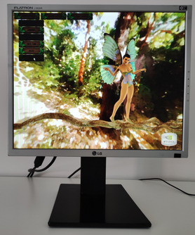

I also got this 19" LG Flatron L1953HR monitor. Same brand as my old one, same series, just bigger. Back when I bought the 17" version (around 2006 I think?), I always felt like I missed out for not getting the 19"model. It was out of my budget range at that time, but it's fairly affordable now, and I'm very happy with having a bit more real estate on my retro rig. Oh, and in case anyone's wondering, that fairy is from Nvidia's Dawn demo.
More benchmarking, tweaking and pics will likely follow during the next couple of weeks, as time permits. I'm currently in the process of moving so things are a bit hectic.

Nice, enjoy your new card! 😀
It's good that the fan is still working perfectly. I had to replace it on both of my A350XT cards (bought three original fans from a chinese seller a couple of years ago).
I think I've mentioned this in the past, but as crazy as it sounds, make sure to restart the OS multiple times and do the same benchmark.
It's a weird behavior that I noticed with some of these late VIA chipsets: the 3D performance can sometimes be ~ 10% slower once in a few restarts (not entirely sure what's causing it, but never bothered investigating it further - since 400 FPS vs 450 FPS is not that big of a difference 😁 ).

chrismeyer6 wrote on 2022-08-12, 11:51:
That leadtek is a nice looking card. I like how the cooler has a dust filter built in.
Yeah, it's pretty nice.
I like the automated fan control too. The card is nearly silent at the desktop and it ramps up as needed during 3D gaming. But even at full load, the noise levels are quite reasonable.

Cheers! 😀 BTW, I have a question with regards to forcing the 45.23 driver. Currently, I'm manually installing the 5900XT as an 5900 Ultra, see pic:
141.93 KiB
1196 views
However, this results in the driver info screen listing the GPU as "NVIDIA (Unknown)" and games which use this info (e.g. Quake 2) also list the card as such. I've also tried adding the following lines to NVAML.INF in their respective sections:
%NVIDIA&DEV_0332.DeviceDesc% = NV30,      PCI\VEN_10DE&DEV_0332
NVIDIA&DEV_0332.DeviceDesc="NVIDIA GeForce FX 5900XT"
Those lines were taken from the 56.64 driver. And by doing that, I can install the card as an 5900XT, but the driver info screen still lists it as an "NVIDIA (Unknown)" GPU. Can this be fixed and does it even matter? I gather it's probably just a cosmetic issue.

chrismeyer6 wrote on 2022-08-12, 18:26:
How are the temps with that cooler?
At stock clocks, around 38C idling at the desktop and 59C under full load.
This is with an suboptimal environment though. My new place doesn't have air conditioning (yet) and my retro rigs are packed too closely together. I also plan on adding an intake and an exhaust fan to the case, since I'm now using more powerful hardware.

Joseph_Joestar wrote on 2022-08-12, 17:45:
This has also "bothered" me, but I confirm that it's purely a cosmetic issue, indeed.
As far as I can tell, it has nothing to do with the INF file, it seems to be something more low level (a GPU core identification routine built into the driver itself). Now, what I find odd is the fact that both the GeForce FX5900(Ultra) and the GeForce FX5900XT are NV35 chips, so you'd think that the driver should just identify the XT as a FX5900. But, no, it seems there are also other differences that the driver is able to somehow spot.
Either way, it's not something that affects game performance/compatibility in any way.
