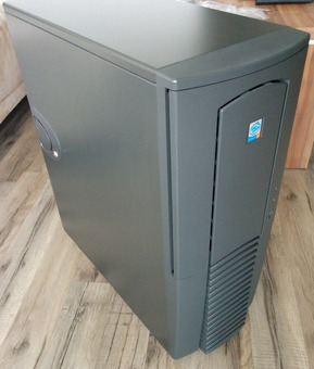

All parts built into my favorite case, the chieftec midi tower.
