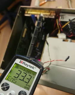

A single beep on start up should be normal, so can't say for sure that the CPU is dead. Often you would get a specific beep code for CPU issues. Take off the heat sink and feel if the CPU runs hot at all.

Oh, it's an extremely short beep, we're talking milliseconds, almost immediately after power on. If I were to guess, it's just the buzzer reacting to the circuitry becoming energized. Like the DC pop when you plug in headphones/speakers or something.
The CPU temp slowly rises to and stays at ~33 deg C after being powered on for ~10 mins without heatsink. Assuming you could expect something way higher from a fully working CPU even very early in the boot sequence? The rest of the SBC is just about the same temp too, might just be the CPU being warmed up by the peripheral components.
