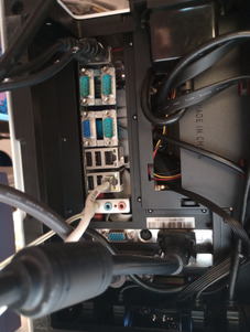

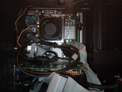

This is my Windows 98 workhorse for playing around with old games and software because it takes up such little space. Originally I had done this build with a couple of different VIA epia boards but they were a bit too anemic when it came to playing some games. Was then planning to use a Pentium M ITX board but was outbid on ebay. Eventually this socket 478 board cropped up for a reasonable price so I bought it and waited for it to come across the ocean from Great Britain to me in the US.
The board is a DFI G4G100-N and has a spec sheet on the manufacturer website: http://www.dfi-itox.com/pages/products/mother … ol/g4g100-n.php

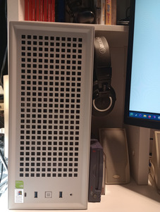

Size makes it easy to jam into the Ikea desk I'm using.

So as for the bits and pieces:
-Hyte Revolt 3 case
-DFI G4G100-N mobo
-512MB DDR 400 ram
-PCI Fx5200 graphics card since I only have a single PCI slot to work with

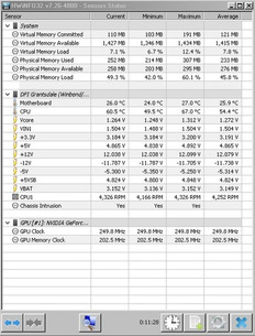

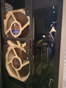

Glad you had me check, I hadn't installed fans after switching out the Epia board since it runs relatively cool. Was idling in the BIOS around 60C. After I get some fans installed what benchmarks would you like me to run?
Case also has quite a few mounts for for fans given it's small size!
https://archive.org/details/@detritus_olentus
Philly Burbs.
Reply 8 of 10, by detritus olentus
Alright, have added some very lovely Noctua fans. Tested it sitting idle and then with a very built-up save file on Chris Sawyer's Locomotion and here's the temps! Got as low as 49.5 idle and topped out at at 67.
