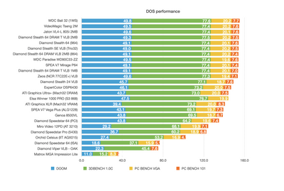

Reply 3 of 8, by mpe
Yes. I've seen WJG6260's tests. I think performance of VL-Bus cards in DOS PCB/3DB/Doom/etc. is now quite well undestood (and frankly nothing to write home about). Basically ARK1000 slighly faster in DOS than anything else with late S3 and Tseng chips following and Cirrus Logic/Trident/ATI all in spitting distance and then followed by GUI optimised cards with sub-optimal DOS performance.
I'll try to focus on CAD and GUI performance with different drivers, performance in Linux xfree86 server (where available), performance at high CRT refresh rates, drivers and other stuff that made those cards actually different. It is sad to see Matrox Ultima VLB or Viper VLB so lagging given how big powerhouses they actually were.

WIP data:
