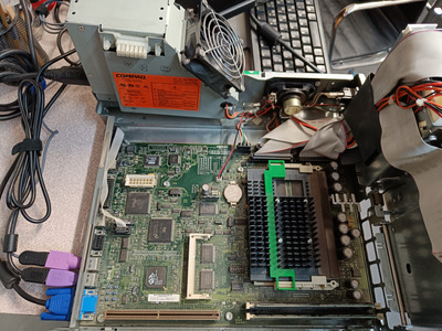

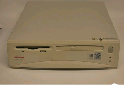

Since I've been getting more into retro games I managed to pick up a nostalgic desktop system to play around with in Win98. It turned out that an early P3 was much more affordable than the kind of Socket7 system I actually remember as my first computer.
This is it: a Compaq Deskpro SFF, which arrived with a slot 1 Pentium III 500mhz, 128 Mb RAM, and a 20Gb Quantum hard disk and laptop CD-ROM. I deliberately wanted a small desktop machine with a riser card, both for space, and nostalgia.
54.25 KiB
1891 views
Seller's original photo.

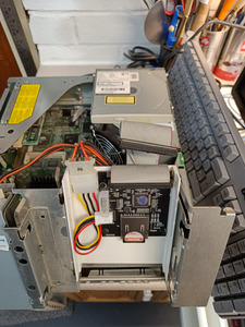

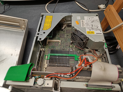

It's a very neat design, with the drives and PSU hinged off the chassis, and integrated ATI graphics and ESS 1869 soundcard (which I believe is an ISA PnP chip?). To my surprise there's even a decent mono speaker beside the drives, connected to the motherboard with a 2 pin JST type connector for totally on board sound. I realise the proprietary PSU, with totally proprietary connector, could turn out to be an Achilles heal though...
1.95 MiB
1891 views
Everything worked out of the box, and I was able to install Win98SE via boot floppy and CD. However, the Quantum HDD has quite the constant whine, a well as the traditional access noise I remember, so for now I've fitted an SD card IDE adapter with a standard SanDisk 64gb card. I fashioned a kind of bracket from styrene plastic card.

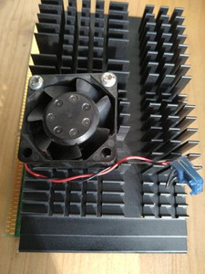

It's interesting that although you have a PIII 500 Katmai, it's only fitted with a passive cooler. I only have a 50 MHz faster CPU (550) and it was fitted with a small noisy fan powered from the mainboard. Passive-cooled I have a PII 350 Deschutes, where the mainboard does not have a connector for cpu fan.
In addition to the 2 mainboard versions, these machines also had 2 PSU types - 90W and 120W - what version do you have?
The internal speaker automatically disconnects when detecting the connection of the AUDIO OUT jack on the back and I don't personally see any disturbing sound on my piece (CPU fan I have replaced).
If you will install a different audio card, it is necessary to turn off the existing onboard in the BIOS (device security option).
Mine works without problems with Coppermine Celeron 900 (via slotket) and Voodoo3 2k, TNT2 M64 (and Radeon 7200 PCI - but here 90W PSU discourages me from using it permanently).

Mine came with a 550 CPU and no fan, I think the cooler above must have been modified.
Reply 5 of 21, by Ydee
Oetker wrote on 2023-01-09, 10:14:

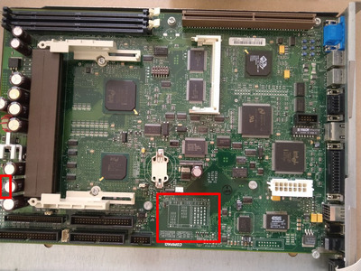

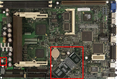

I doubt that, because the two boards differ apart from the minor details just in the presence of the CPU fan connector. Also, fan screws are typical "compaq" with grooves for a flat screwdriver or TORX wrench. The cable is very short just enough to reach the connector.
    245.99 KiB
    1793 views
    268.52 KiB
    1793 views

Many thanks for all of these very helpful comments! The "kentie" article was very interesting too.
Looking in more detail, it looks like I have the older revision of the motherboard PCB, and just a 90w PSU. I was mistaken on thinking there was also a buzzer - will the internal speaker still work as a "pc speaker" if a standalone sound card is fitted?

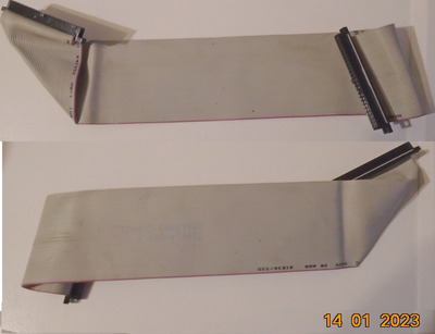

One other thing is I've noticed the CD-ROM cable is quite damaged. Where it's been folded over as part of the velcro cable management it's worn through enough to see bare metal, and the drive end cable clip is snapped on one side. I was expecting it to be 44-pin, but it actually seems to be 50-pin! That seems really unusual - any tips on what to search for to find a replacement? There seem to be a handful of ribbon cables on eBay described as 50-pin, including some described as SCSI, but it's hard to tell if the spacing is right ...
The cable to the CD drive is therefore 50 pin, as it not only transmits audio and data signal, but also provides power to the drive. There's no other power cable going into the drive.

Any ideas of what to search for in order to find a replacement for this cable? It LOOKS like all of the 50-pin ribbon cables I can find on eBay UK are SCSI cables, which seem to have a 2.54mm pin pitch, the same as a normal IDE cable. The Compaq CD cable is much denser (looking like a 44-pin laptop style IDE, just wider). On the motherboard photos above, you can see the 50 pin connector is actually narrower than the 40 pin ones. So I figure it must be 1.27mm pitch, like laptop 44-pin IDE?
The closest I've found is this at Mouser: https://www.mouser.co.uk/ProductDetail/Harwin … 7JwUBPYLg%3D%3D
Equivalent product spec for a different brand, set out in a helpful format here: https://www.mouser.co.uk/datasheet/2/527/ffsd-2854094.pdf - so basically 1.27mm pitch, double row x 25 position, female to female.
Which seems insanely expensive at £33 for a 30cm cable! RS have a similar one slightly cheaper at £21 https://uk.rs-online.com/web/p/ribbon-cable/9011790 - but that still seems very expensive for a cable! Rapid and other UK go-to electronic component suppliers seem to sell only reels of the cable at proportionate prices, no connectors.
Does anyone know if there any other way this cable might be described which might help me find one (second hand?) at a more reasonable price?
Otherwise I'd just be tempted to wrap the damaged wire insulation sections with Kapton tape, and repair the snapped connector clip with glue (Would PlasticWeld work on the kind of plastic used? or would it have to be epoxy?). It does actually still work, just seems not ideal to leave it in this condition / in need of restoration.

The correct part number is 314014-001 (should be printed on the cable)...usually described something like "Compaq / HP CD-ROM cable (IDE)". Think I have a spare somewhere - if you're still looking, and I find it, you can have it no charge 😀

Finally found the little beggar! 😀 ...it's the original cable from my own (currently busted) Deskpro SFF P3 450 - I replaced the original working CD-ROM drive and the new one came complete with cable.
451.35 KiB
1425 views
Think I can still DM you, and you can read it but can't reply, so I'll include alternate contact & details there if that's OK.
