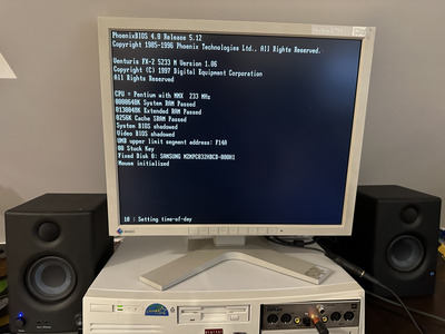

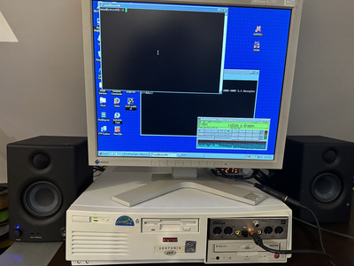

My objective was to build Windows 95 / DOS machine to use as
  • MOD music player
  • make some MIDI, MOD music
  • play games
  • sporadically use it as a stationary type writer
Instead of going through the entire build process, I utilize the Digital Venturis FX-2 machine. I mainly choose DEC because of its great sentiments for DEC company.
MY FX-2 comes with P166MMX, Onboard S3 Graphics, 32MB of RAM, 8GB Hard drive, 3Com Etherlink III ISA card. But, unfortunately, it doesn't come with a CD drive or Music Card.
I started my build with the cleaning process and replaced two old fans. It was easy to find a replacement, one fan was regular 50x50x10mm, and the other in the power supply was 60x60x15mm.
As one of the main aspects of my build is music, I purchased Terratec EWS 64 XL and the MCCake MT-32 emulator for the Waveblaster slot. So now I have three different synthesizers (Dream, OPL FM, and MT-32) on the one card plus SB16 emulation.
All of it works under DOS And Windows 95.
Next was a graphic card as I wanted to play some dos games and still preserve support for some windows DirectX and voodoo glide application. I choose Indivision Voodoo Rush 4MB with an AT25 chipset. So when I sorted out the graphic card, I started to look into the storage. I purchased a 32GB mini SSD plus 2.5 adapters. As I would like not to hear any mechanical drive sounds. With that, I added Philips rewriter CDD 3610 and some more RAM, pushing it to the 128MB of ram.
My last addition was 233MMX Pentium, which doesn't change much in this build. But it makes me happier that I maxed out my CPU.
So, I end up with below config:
  1. Digital Venturis FX-2 machine
  2. Pentium MMX 233 Mhz
  3. 128MB RAM (2*32, 1*64)
  4. 32GB SSD + 3.5" adapter
  5. Terratec EWS 64 XL with MCCake MT-32 (ISA)
  6. Innovision Voodoo Rush AT25 4MB (PCI)
  7. 3Com Etherlink III (ISA)
I'm pretty happy with it. However, I am still wondering if that is the best graphic. Does it work better under Quake I when I swap for some Riva 128 on a PCI slot?
Below, you can find some photos.

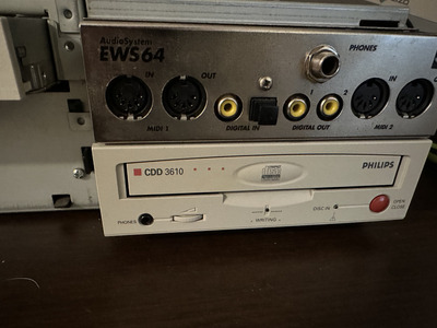

Reply 5 of 6, by sndlbn
My first choice was AWE64 Gold. However, I was not satisfied with MIDI Soundfont's quality in DOS games, so I started looking for something that could give me "better quality" sound plus DOS capabilities. I found this card attractive as it has two different synthesizers, FM and Wavetable, based on DREAM out of the box. To add, it also has a Waveblaster port (I'm using it for MT32 emulation). So it has far more abilities on one ISA port than any other card. Additionally, it has SPDIF output which I use to drive better headphones, through an external DAC and amplifier. As you said, the headphone jack is very noisy, and as far as I realized this I switched to the spdif port.
jheronimus wrote on 2023-02-01, 12:59:
Nice build! How are you liking the EWS64XL so far? Don't see people using that card too often lately.
I own one, and it's a pretty cool card, but damn my headphone jack is noisy 😀 Maybe I'll give it another go after shielding the cables with tinfoil or something.
Reply 6 of 6, by sndlbn
As you may see in the last photo, it is my choice. Unfortunately, I'm using SPDIF and external DAC with a headphones amplifier. Also, I couldn't find separate volume control for headphone output, but it could be that I'm missing something.
