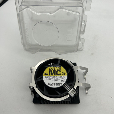

Reply 105 of 167, by Irinikus
Just a question, will a socket 370 cooler fit a socket 8?

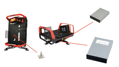

Reply 106 of 167, by Irinikus
This year I'm going to go ahead with this build:
The InWin X-Frame 2 has the perfect number of slot positions to properly accommodate this motherboard, but as the board has an AT form factor, the standard tapped standoff holes are in the wrong positions to accommodate this board. Rather than drill and tap new holes into this expensive motherboard tray, for now I plan to make use of period correct plastic standoffs, which I'll neatly epoxy into position, as the double-sided tape that they come fitted with won't offer a permanent solution.
I have a nice 1.22MB floppy drive as well as a SCSI DVD-ROM, both with black bezels, which I'll slot into the lower drive bays. (Seeing that it's a dual Pentium Pro, it will definitely need a floppy drive!)
660.21 KiB
687 views
I really hope that once I've flashed the BIOS to the latest revision , the Voodoo5 5500 PCI will fire up in this system!
YouTube
Reply 107 of 167, by luckybob
The socket 7 heatsink is adequate to cool a ppro, provided it contacts the whole gold top.
The heatsink clip is incompatible.
Reply 108 of 167, by Irinikus
luckybob wrote on 2024-01-31, 14:58:

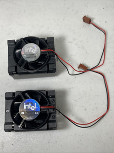

Thanks for the reply! 😀
I've already decided to make use of the standard heatsinks that these CPU's were released with!
246.82 KiB
681 views
YouTube

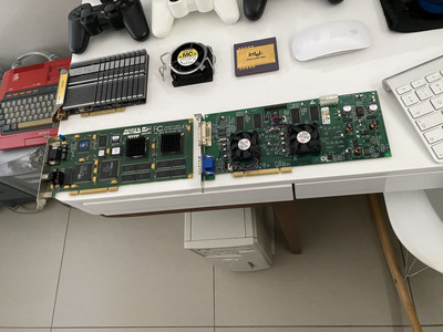

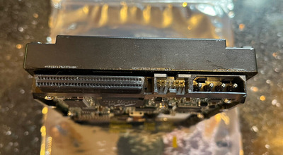

Reply 112 of 167, by Irinikus
luckybob wrote on 2024-02-01, 04:37:
300/600 gb drives are going to be even faster than 73's
They are harder to find though.
Not in any meaningful way, but if the plan is to swing your dick around...
I agree, but I was able to get two of these drives for a very good price:

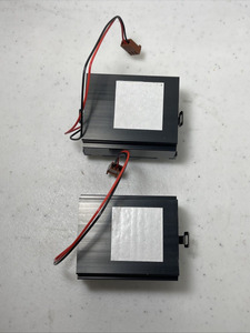

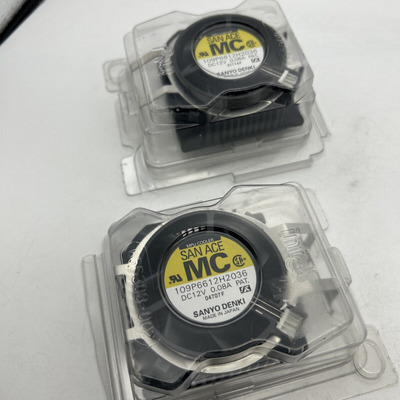

And these two CPU coolers: (NOS)
282.27 KiB
571 views

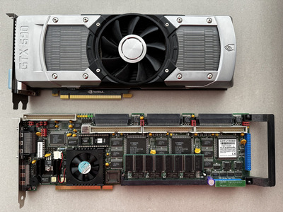

Reply 113 of 167, by Irinikus
On this base board, PCI slots 4 and 5 share the same IRQ and the Media-Bus card card needs to go into slot 5, so I'm going to have to slot the SCSI RAID card into slot 2 (This is a very long card so it will block two of the RAM slots unfortunately!)
1.59 MiB
553 views
I'm probably going to slot a USB 2 card into slot 3.
And the Oxygen 202 will be replaced by the Voodoo5 5500 PCI if I can get the latest BIOS revision to fire it up:
1.73 MiB
546 views
YouTube

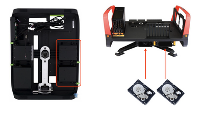

Reply 117 of 167, by Irinikus
Thanks for the input! 😀
They do tend to get pretty warm indeed!
I intend mounting them in these positions on the back-side of the X-Frame 2: (The drives will be exposed to the open air, but I will setup a fan arrangement if necessary.)
860.28 KiB
374 views
The pictures shown, show the internals of the actual drives I've ordered.
I intend to orientate the X-Frame 2 vertically on its stand
YouTube

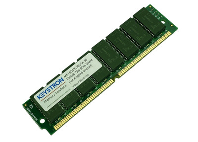

Reply 118 of 167, by Irinikus
I'm considering this RAM for this card! (I'll only make the purchase once the machine is fully assembled and running)
1.85 MiB
345 views
This is the only 50NS 128MB SIMM I could find and my only question is whether SIMM's for the Amiga Blizzard 1230IV 1230 IV are standard 72-pin memory? (This is obviously not ECC emory)
127.48 KiB
349 views
My card is currently fitted with a 60ns 128MB ECC FPM SIMM. Would it be worth swapping this out for a 50ns 128MB non-ECC EDO SIMM?
YouTube
