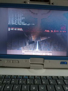

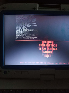

Reply 54 of 62, by Hoping
A friend lent me a 4GB DDR3 memory module, so I started testing again with the Atom N2600 (GMA3600) and although now the laptop responds much better, nothing has changed regarding its performance in games, using D3D compatibility is quite bad but with OpenGL the performance is quite good for a 3.5W CPU.
GLQuake, Quake II and Quake III at 1024x768x32 bit have very good performance. In GLQuake and Quake II it seems that Vsync is activated, but in the drivers it cannot be explicitly disabled.
In Quake III there is no such problem when benchmarking, and it reaches 74.1 FPS, which puts the GMA 3600 above a Voodoo4 according to Phil's results (https://www.philscomputerlab.com/3dfx-voodoo- shootout-project.html), but I used 32bit color depth instead of the usual 16bit of 3dfx. I mention it because it seems curious to me.
I Also tried Medal of honor allied assault and Jedy Knight II, both use the Quake III engine and both run perfectly on the GMA3600.
Any suggestions for other games that use OpenGL to try? That don't use the Quake engine.
