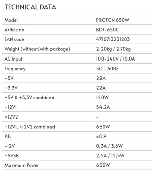

Reply 6 of 27, by CENTRAL
So, this Kolink is a somewhat typical current PSU in the mid-price range.
Would you say it is ok to use it?
Reply 8 of 27, by Munx
When you pick a model, look for reviews that show how well it deals with cross-loads (when one rail is being used heavily and the other is not).
My builds!
The Underdog - The budget K6

For PSUs, even in retro builds, I make sure to use ones that are at least 80+ Bronze rated.
Seasonic is my brand of choice, but other top-tier brand are fine as well.
The Cheiftec you show doesn't show 80+ of any kind unless that pic is not showing all the specs.
I am not familiar with Kolinc but if it is really 80+ Gold rated (not just a sticker put on there to fool people), then it is probably fine.
Quality modern PSUs are also usually rated for continuous load unlike PSUs from times of yor, when they were rated for temporary maximum load and were also most likely to be rated about twice as much as they could actually deliver at all.

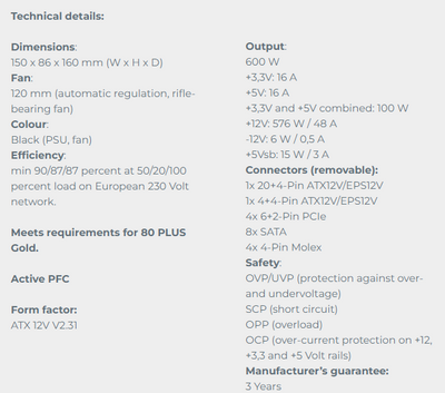

Reply 12 of 27, by CENTRAL
Seasonic is a solid choice!
But they as well have significantly lowered the performance of 3.3 & 5.5 volt rails...
Here is a summary of the Focus PSUs
    36.73 KiB
    1241 views
