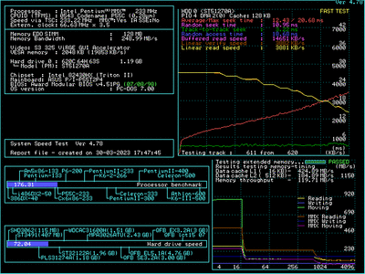

Speedsys screenshot for MMX 233
16.44 KiB
1125 views
MMX Pentiums first. Actually I only tested with a single MMX CPU (233 MHz). I under- and overclocked it for other speeds.
This was a really great CPU. It even overclocked to 262 MHz (3,5 x 75 MHz) without any issues and with default voltage! Just excellent. But It is too fast even with 233 MHz. The best CPU seems to be MMX 200 MHz. It does not suffer from the 200 MHz bug and disabling L1 alone gives excellent slowdown. Or alternatively 187 MHz (2,5 x 75 MHz) could be used for a bit better performance.
Of course 233 or even the 262 MHz is fully usable since MMX Pentiums have other slowdown options in addition to disabling L1. Certainly it could be slowed down just enough for the 200 MHz bug and some other setting in addition to disabling L1 could be used to find sweet spot for OPL speed sensitive games. But that is a little bit more work. 200 MHz is very easy. If you need a faster processor, then maybe K6-2+ or K6-3+ system would be a better alternative.
I would have chosen Pentium MMX 200 MHz if it would have been released in 1996. But no, it is (a very early) 1997 CPU.

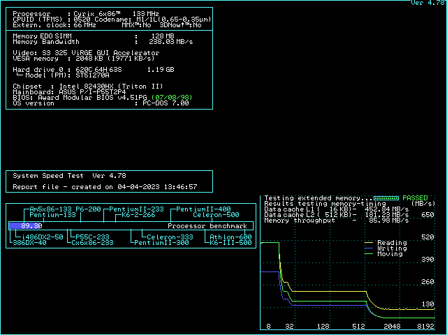

Speedsys screenshots for 6x86
9.8 KiB
1118 views
9.73 KiB
1118 views
What about Cyrix 6x86? I have only one such CPU, IBM 6x86L pr200+. L means it is a low power (2,8V) version released in 1997. But otherwise it is the same as 6x86 pr200+ that was available in 1996.
This CPU is not for this system. It is simply the best CPU in 3DBench. Is that a 16-bit real mode benchmark? The others are 32-bit protected mode benchmarks. Maybe the excellent Cyrix 16-bit performance is what makes it so fast in 3DBench. Other than that it is slower than Pentium Classic 200 MHz in every other benchmark. And Quake performance if awful, barely faster than Pentium 90. Another interesting comparison is to compare pr200+ with P150 @ 75x2 (same bus, same CPU clock). Clock-for-clock, the Pentium is surprisingly close in all other benchmarks other than 3DBench and Quake.
But even bigger problem for this system is that with L1 cache disabled pr200+ is too fast! My guess is that only 16k primary cache gets disabled but 256-byte instruction line cache remains enabled. Pr166+ with L1 disabled is slow enough so it could be used in this system. But why? Pentium is simply a better alternative here.
I ran CHKCPU before running Speedsys. CHKCPU enabled CPUID instruction that is disabled by default. This is a compatibility thing to make 6x86 look like a 486 CPU since it is not fully Pentium compatible. Cyrix 6x86 is like a super fast 486 that works on a socket 7 motherboards.
6x86 is supposed to be faster on non-Intel chipsets and some BIOSes might tune the 6x86 better. So 6x86 might be faster on some other motherboards and there are many programs to tune 6x86. I did not test them here.

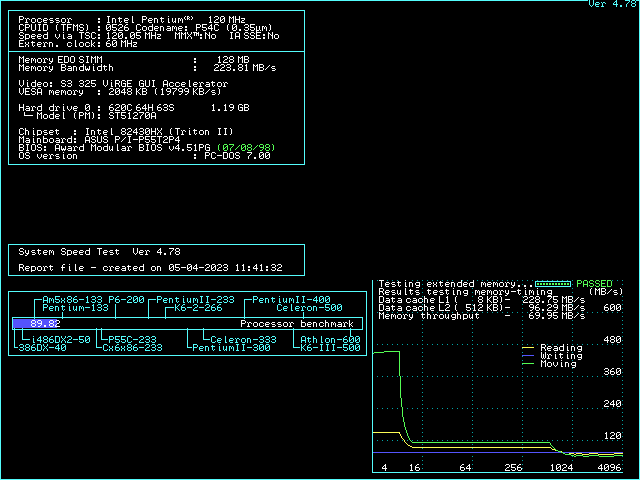

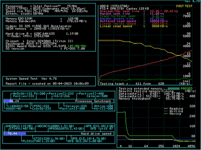

Pentium 75, 90, 100 and 120 MHz Speedsys screenshots
15.95 KiB
1114 views
9.59 KiB
1114 views
9.69 KiB
1114 views
9.68 KiB
1114 views
How good are the slow Pentiums? I wasn't going to test anything below P120 but then I started to wonder if any of them was slow enough for the original 256 color Indy3 without any patches. And one of them was. The only CPU that was slow enough was P75 with L1 cache disabled. It is the only Pentium that uses 50 MHz bus and that makes all the difference. I suppose I could have tested how 2x50 or 3x50 MHz CPUs do and maybe I will later.
Bus speed matters a lot. Pentium 120 MHz (2x60) is only a little faster than Pentium 100 (1,5x66). Pentium 120 is a good CPU otherwise since you can just set it to 133 MHz and it will almost certainly work at 133 MHz. If you really want a slow Pentium, then 75 MHz is the one to go with (because it is so slow with L1 disabled).
I didn't have 75 MHz Pentium so I used the 90 MHz one and underclocked it.

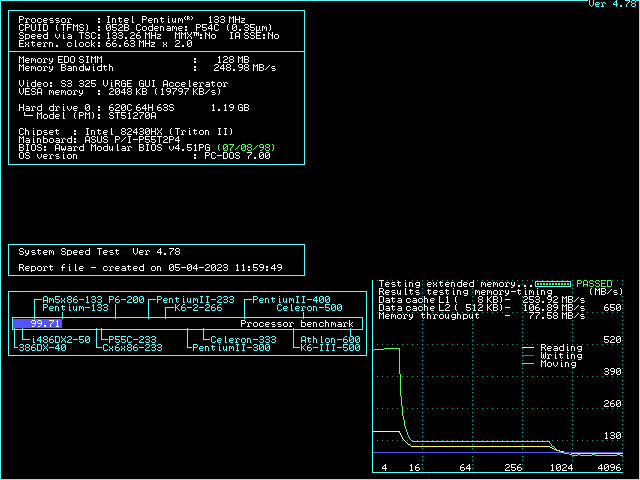

Speedsys screenshots for P133, P150 (2,5x60 MHz)
9.71 KiB
1099 views
15.97 KiB
1099 views
Looks like I forgot to save results from P166 and P150@2x75 MHz.
P133 is a good CPU. 66MHz bus speed helps here and makes it easily faster than 120 MHz Pentium. Pentium 150 is a disappointing CPU, at least with the default 60 MHz bus speed. On some benchmarks it is actually slower than P133! Pentium 150 should have been left unreleased. Unless you just change it to 2x75 MHz (same as Cyrix 6x86 pr200+). That makes it a completely different CPU! 60 MHz bus hurts a lot since with 75 MHz bus and 150 MHz CPU it is faster than P166. And this one works with 3,3V unlike the P166 I have. It requires 3,5V but I believe there are P166 CPUs that work with 3,3V.
P150 @ 2x75 is really a positive surprise. And since that CPU came with this motherboard, I would have kept it in this system if I had not ordered the P200.
P166 is a little disappointiment. It is easily faster than P133 (and P150 with 60 MHz bus) but it is no match for P150 using 75 MHz BUS. This CPU is already factory overclocked since 3,5V is required and this CPU cannot be overclocked at all. 187 MHz is simply unstable. I didn't test but this CPU should work @ 2x75 like the P150. Likely I could lower the voltage to 3,3V as well. It would give better speed but I wouln't feel comfortable underclocking it. That is why the P150 is a better CPU.

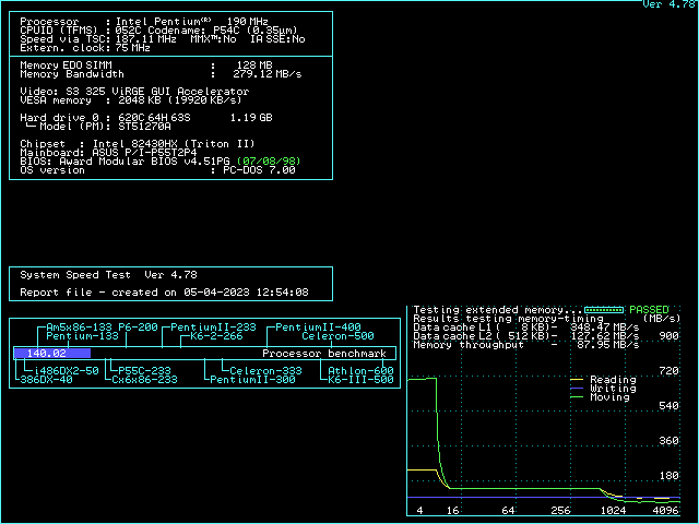

Best of 1996 CPUs, Pentium 200 MHz
16.1 KiB
1055 views
9.7 KiB
1055 views
9.74 KiB
1055 views
A good CPU and fastest of Pentium classics. Cyrix 6x86 is faster on some things but overall Pentium 200 was faster here. Quite uninteresting CPU otherwise. With L1 disabled it performs very close to all other Pentium classics with 66 MHz bus. With L1 disabled, it is the bus speed that matters. But that is a good thing since that means P200 is not too fast and can be slowed down nicely.
When compared to MMX 166, P200 is only a little bit faster. But runs hotter. It is another factory overclocked CPU that requires 3,5V and cannot be overclocked. I believe all P200s use 3,5V. It does not have 3,5x multiplier but it doesn't matter since even 225 MHz (3x75) is too much for this CPU. Quake tests did not finish with L1 enabled.
But some more performance can be gained. 187 MHz (2,5x75) is a little faster than 200 MHz. But not too fast so disabling L1 gives nice speed. I need to try if 3,3V could be used with 187 MHz. But maybe 200 MHz is the thing to have, after all, 200 MHz was the best in 1996.
