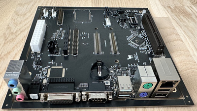

Eivind wrote on 2023-09-04, 12:55:
Just got the boards in, plopped on a Geforce4 Ti4200 AGP card, and got video! 🎉

Reply 182 of 475, by Eivind
640K!enough wrote on 2023-09-05, 02:09:
It's always nice when things work as intended. Did that require any additional bring-up code, or was it all configured at the hardware level, and worked without BIOS-level changes? Any idea what the compatibility list will look like?
No additional BIOS code needed, as I understand it AGP is simply a superset of PCI, with all of the additional hardware features (extra pins) optional, at least for AGP 1.0 (3.3V, 1x). I want to try more cards, looks like I have at least a Geforce FX 5200 in my old parts bin but some of its caps looks...rather sketchy. Will get more cards to test with!
Looking at this thread from a couple of years ago, it seems most older cards will work just fine.
Now, on to programming the new and revised LED/clicker + the RP2040 USB-to-PS/2 controllers...

Reply 186 of 475, by Eivind
Yes! Got a usb keyboard-to-ps/2 setup using the bit-banging branch of this library working on the rp2040 on the native usb port. Hubs seem to work fine as well, my HHKB that's been collecting dust can finally be used again! 🎉
This is looking very promising indeed, now I gotta get the dual usb host configuration up and running.
As a side note, I forgot to level-shift the keyboard/mouse data and clock signals going into the rp2040, but it seems it can happily cope with what I measured to be around 4.8V without complaining - even though it's not rated to be 5V-tolerant. Definitely something to address later, but nice to see it worked.

Reply 189 of 475, by Eivind
Got the TinyUSB library working with two (native + PIO-based) USB hosts, and tested keyboard + mouse to PS/2 translation. Works well enough in DOS, though a little more tweaking is needed to avoid weirdness when hot-unplugging hubs. Very promising overall. Another board revision that takes care of the crystal goof and properly level-translates the PS/2 signals is arriving later this week. We're getting closer...

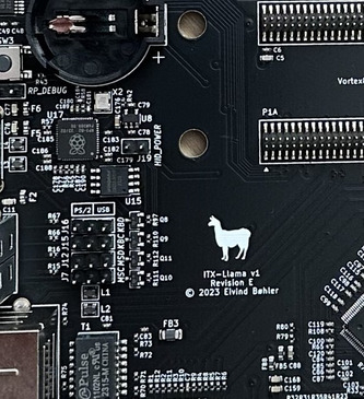

Reply 190 of 475, by Eivind
Update: Got revision E (fifth prototype) in, level translators work fine. The RP2040 firmware for USB-to-PS/2 conversion works more or less flawlessly. Also tested the board with an ATI 9250 without issues. I think this might be it, I've yet to test digital audio output in Win98 as well as the ESP8266-based dial-up addon, but other than that I think I'm altogether mostly satisfied. No more hardware errata that I'm aware of at least! 🤞

Reply 192 of 475, by jamesfmackenzie
Eivind wrote on 2023-09-30, 16:46:
Amazing news! I’m very interested with these become available! 😎
