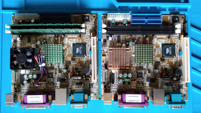

The short story is, that lead me to the EPIA-800 as the core of my new build. No expansion card(s), 800MHz C3 CPU, 512MB PC133, integrated Trident CyberBlade graphics with 8MB VRAM, and AC’97 sound with full DOS Sound Blaster Pro emulation, more than enough for the games I want to play on it. Not having a game port, no USB game pad support, I tracked down a new , and awesome, Gravis Stinger COM port gamepad for it! Running Win95 OSR 2.5.

But...If I had the dual riser, I would do a second build using both a sound and video card since I have a second EPIA-800. Well, 3 actually, but one needs repair.
Sadly, I can only find one...

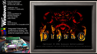

DOS performance is great for all the games I've played on it so far. Windows 3D performance is what I expected, 25-30 FPS in the many games with some going higher, and I'm fine with that. Everything else I've tried so far runs excellent. I really could not be happier with this little EPIA-800's onboard hardware. Great retro gaming board in this old geeks humble opinion.
