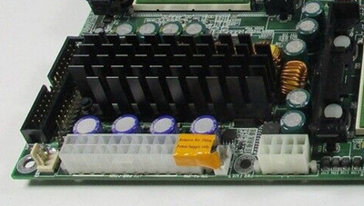

Apparently, the only difference between the P4DC6+ and P4DC6+II is the heat sink on the VRM. (According to the manual)
So could I not solve this problem by placing a custom heat sink on the VRM?
If worst comes to worst, I’ll fit two 2.8GHz XEONS with 2MB of level 3 cache, as the board is validated to run CPU’s @ 2.8GHz according to the manual.

My thoughts too...trouble is its difficult to know if they uprated the VRMs at the same time unless someone has the +II and could pull the sinks and check

For now, what I’ll do is fit a heat sink to the VRM and slot a pair of 2.8GHz 2MB CPU’s and see how it goes. (Measure the temperature of the VRM in that configuration and then decide from there.)
If I wanted to beef up the VRM, could I do so by swapping out the FET’s for more beefy ones?

Another cryptic 'no you can't' from SM https://www.supermicro.com/support/faqs/faq.cfm?faq=939

Understandable, tho you do continue to wonder just how redesigned the +II really is...a side -by-side check of the boards online shows no discernible difference save the chunky heatsink on the VRMs (did they actually redesign / uprate the VRM circuitry or just add a couple of push pin thu-holes to secure the heatsink?)
The attachment P4DC6plusII.jpg is no longer available
I have noticed that the inductors on the +II appear to have more windings! So there must be a difference!
