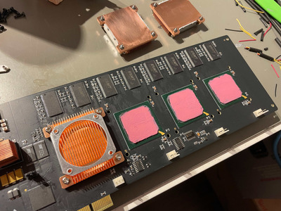

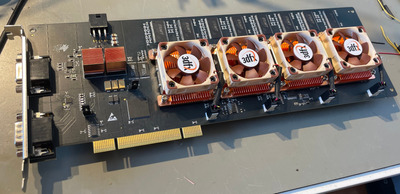

First at all i had a look on the voodoo. Checking the hotspots. Its not really a need to done this but why not if you got such beast i not stop.
So First i did some cooling mods on my v6000. I replace the Fans for Noctuas, also repleaced the TP with Kryonaut extreme. At least i add some coolers to keep the temps down.

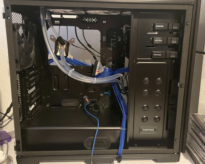

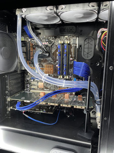

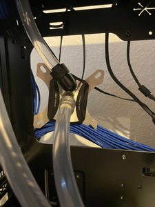

So the Voodoo 6000 is a huge board and its heavy too. I choose this Phanteks case what gives me the space.
The CPU Water block is from Aquacomputer, also the Tube with pump. It runs over a 360 cooler on the top.

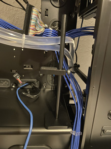

Reply 4 of 9, by H3nrik V!
Have you considered supporting the weight of the board, now that you mention that it's heavy?
Reply 6 of 9, by Jackhead
1.6 MiB
984 views
what i use, its not possible to install the voodoo without.. Big old Lady ^^

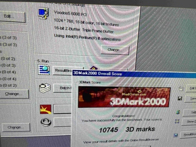

Reply 9 of 9, by Jackhead
Got it pushed to near 11k with 185MHz on all four VSA100 and 4,75GHz on the E8600
911.51 KiB
642 views
All chipset Driver for P35 running on win98SE. AHCI Driver work very fast for the Sata SSD
