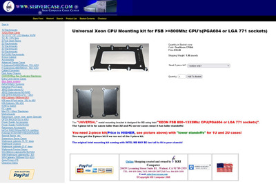

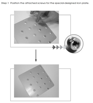

I received my motherboard and goodies today and realise that I have a bit of a problem to solve! The CPU coolers need to be chassis mounted, as they weigh in at 920 grams each! (And they're designed to be chassis mounted of course!)
So I'm going to have to get a plate made up which is tapped in the right places in order to secure the CPU coolers!
I've plotted where these holes would need to be drilled and tapped, but am currently undecided as to whether I want to mount the plate to the motherboard side of the motherboard tray or not. If I do decide to mount it to the back side of the motherboard tray, I'll need to drill one hole through the motherboard tray, as depicted by the red circle in this picture. The blue circles depict holes already present in the motherboard tray which will be use to secure the plate in place.
If any of you have faced this dilemma before, any advice would be welcome!

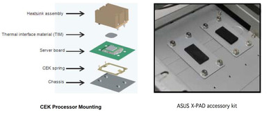

Reply 56 of 243, by PC Hoarder Patrol
A number of the big board maker shipped their own backplate solutions for this class of boards, though Tyan doesn't seem to have been own of them 🙁
My Asus NCCH-DL & NCCH-DR boards both came with the X-PAD accessory kit, with adhesive backplates plus various heights of threaded nuts and rubber pads (these replaced the CEK springs)...
122.44 KiB
843 views
...and my Iwill Dh800 came with a full size backplate to be screwed to the chassis...
42.23 KiB

You also used to be able to get similar generic solutions like this - hard to find today though...
253.42 KiB
843 views
If making your own, watch the height of the tapped threads (may have to add small threaded spacers) so as to apply sufficient load when the heatsinks are screwed fully down

PC Hoarder Patrol wrote on 2023-08-15, 23:59:
A number of the big board maker shipped their own backplate solutions for this class of boards, though Tyan doesn't seem to have […]
Thanks very much for the info!
I intend to have the plate made up from 4.5mm plate aluminium. I checked the distance or depth to which the screw posts extend and they line up with the underside of the motherboard and the maximum extension length of the screws beyond that is 4mm with the coolers sitting on top of the CPU’s. A standard standoff is 6mm in length, the plate aluminium that I'm going to have made up has 1.5mm less height, so it will be able to take the full length of the screws beyond the screw post (The screws will be able to be driven 2.5 mm into the aluminium before the coolers starts exerting a downward force on the CPU's), driving the screws to a depth of 3.5mm should allow for a sufficient amount of pressure to be applied to the CPU’s. I'll make use of "tube spacers" to apply pressure to the CEK springs if required.
