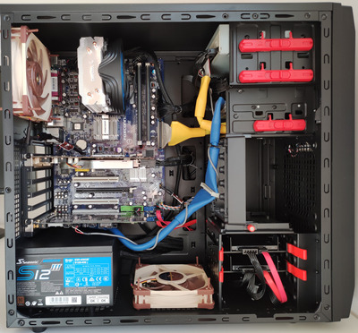

This is a Windows 98 system based around LGA775 and using a PCIe graphics card. As usual, I got inspired by a video from Phil, so I wanted to build something similar.
CPU
This Core 2 Duo E8600 CPU is very overpowered for Win9x gaming and provides awesome performance even in the most demanding titles. Cooling is handled by Deepcool Gammax 200T which keeps temperatures at manageable levels while being quieter and more efficient than Intel's period-correct coolers. I've also installed two 120mm Noctua case fans to further help with the airflow.
Motherboard
I like the Foxconn P35AX-S because it still has floppy and IDE connectors, as well as plenty of PCI slots. I'm using the SATA ports for my SSDs (in compatibility mode) while my DVD drive is hooked up to the IDE port. There are no official Win98 drivers for this motherboard, but unofficial ones can be downloaded from here. One issue that I initially encountered was that GPU performance under Win98 was reduced significantly if 4GB RAM was installed. Lowering the RAM amount to 2GB has solved the problem.

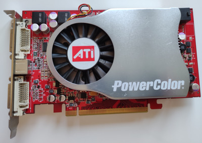

Graphics card
This PowerColor X800 GTO 16 has enough power to run every Win9x game released up until the tail end of 2001 using the 1600x1200 resolution at 60+ FPS. In most titles, it can sustain that level of performance even if Anti Aliasing and Anisotropic Filtering are fully cranked up. I'm using Catalyst 6.2 drivers under Win98 and Catalyst 7.11 under WinXP. Note that this card doesn't support legacy features such as table fog and paletted textures under Win98. That said, table fog does work under WinXP when using Catalyst 7.11 drivers or newer, but paletted textures are still unsupported. I should also mention that the cooler on this card is noisy. The loudness is not quite as bad as on X850 cards, but it becomes very noticeable when the card is under full load. Lastly, unlike most other X800 GTO cards, this one has 16 pipes officially unlocked from the factory. Due to that, Everest mis-identifies is as an X800 XL.

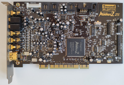

Sound Card
The Audigy2 ZS works quite well as a Win9x sound card. It has excellent EAX capabilities, fairly clean output and can use VxD drivers which are more compatible with older titles. When connected to a 5.1 speaker system, this card is very nice for Win9x games which support surround sound (e.g. Unreal Tournament, Thief II and Deus Ex). Under Win98SE, I'm installing the drivers as per this guide of mine, which means DOS game support is working as well. Under WinXP, I use DanielK's excellent Audigy Support Pack.
Operating Systems
On this machine, I use two separate drives with two operating systems and select which one I want to run from the BIOS boot menu (pressing ESC during POST brings up this menu). The two systems are fully independent, so if I need to reinstall Win98 for some reason, WinXP will be completely unaffected. The Win98 installation procedure on this system is a bit tricky, so I've written a mini guide here.
Windows XP (with SP3) is my other operating system and I mostly use it for maintenance purposes on this rig. However, it's also useful for playing games which use table fog such as Thief II.
Conclusion
It takes a lot of work to set everything up correctly on a system which isn't officially supported under Win98SE, but the end results are well worth it. Performance is simply exceptional, and you can be sure that any Win9x era game that you throw at this system will run amazingly well.

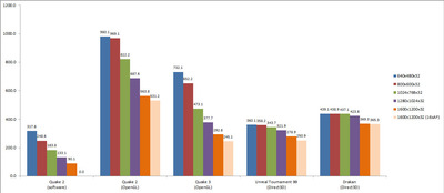

A couple of benchmarks, all carried out under Windows 98SE. For the 3DMark entries, the standard benchmarks were utilized, in whatever resolution and color depth each one uses by default.
236.94 KiB
2690 views
164.27 KiB
3189 views
86.8 KiB
2644 views
53.9 KiB
3189 views
All game benchmarks were carried out using 32-bit color depth. Game versions used:
  • Quake 2 v3.20
  • Quake 3 v1.32c (using demo FOUR with all in-game graphical settings at maximum)
  • Unreal Tournament 99 GOTY (Direct3D renderer, all in-game graphical settings at maximum including Detail Textures)
  • Drakan v445 (Direct3D renderer)

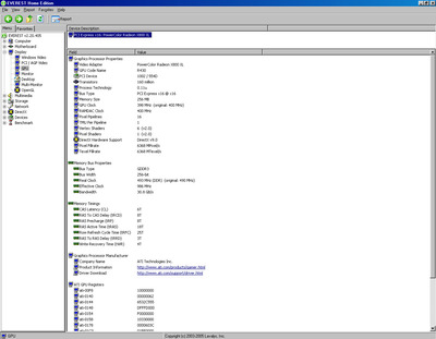

Note: the Audigy2 ZS drivers are installed as per this guide of mine. Also, Everest mis-identifies the PowerColor X800 GTO 16 as an X800 XL due to its 16 pipes which are officially unlocked from the factory. More info about that can be found in this Anandtech review.

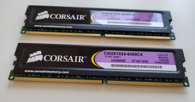

Why aren't you using two RAM sticks? No matter how much you limit the memory to, you will still get the speed boost benefit of interleaving (read: dual channel mode).
For some reason, using two 2GB sticks in dual-channel mode severely reduces GPU performance under Win98 on this motherboard. It's been discussed here.

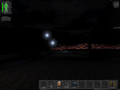

Here's Deus Ex running at 1600x1200 with 4xAA and 16xAF on this system:
194.34 KiB
3040 views
This is using the stock Direct3D renderer with detail textures, vertex fog and volumetric lighting all turned on. Doesn't drop below 100 FPS on Liberty Island, which is an awesome feat for a Win9x rig.
Also, sorry for the poor brightness in that image, but Deus Ex doesn't correctly capture gamma settings when it takes a screenshot. The picture is much brighter in-game, but you should still be able to make out the framerate counter on the right side of the screen.

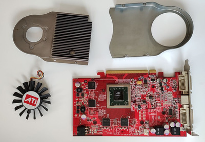

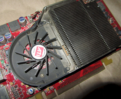

BTW, do you have any advice on cooler maintenance for X800 cards? I'd like to re-paste mine and possibly also lubricate the fan, but this thing looks like it wasn't built to be easily disassembled.

I was actually going to mention the X800 cards and their coolers... I have a few X800XT and X850XT cards, and they are annoyingly LOUD and HOT.
I'm not familiar with the cooler on your particular card, my cards have the typical plastic shroud (as seen in these photos from TechPowerUp).
Those are fairly easy to clean: once you remove all the screws from the card's back, the whole cooler/heatsink assembly comes right off, and on its bottom side it has a bunch of tiny screws that hold the whole plastic enclosure together.
I imagine that yours should be similar, even if it has a different appearance on the surface.
The best option I can think of for these cards would be the Arctic Cooling ATI Silencer 4 & ATI Silencer 5 coolers, but sadly they are very hard to obtain. I actually have quite a few NOS ATI Silencer 3 rev.2 coolers (compatible with the Radeon 9800XT cards), and I was thinking of trying to exchange one of them for a new ATI Silencer 4 and/or 5 cooler.

Cheers! I managed to clean and re-paste it:
284.43 KiB
2955 views
Interestingly, it looks like the previous owner (or someone else) had already done this, but it may have been some time ago. Anyway, with fresh thermal paste and a newly lubricated fan, the noise went down about 5% according to my highly scientific testing method of "put your ear to the case". 😁 Also, temperatures under full load dropped by 4-5°C which is nice as well. But yeah, I wouldn't exactly call these cards quiet, even under the best conditions.

That cooler is just too weak, ATi reference design for Radeon X850 Pro/X800GTO VIVO used copper base and it mostly hovers around 70-72.
Reply 16 of 34, by Joseph_Joestar
The Serpent Rider wrote on 2023-09-11, 17:54:
Good to know, and yeah, I didn't see any copper on the bottom side of this oddly designed cooler assembly. It baffles me that this thing actually pushes hot air into the case instead of expelling it out. The PowerColor engineers should have gone with the latter, even if that meant taking up two slots. No idea what they were thinking here.
Also, the airflow in this cheapo Blueberry case is not great, but it's the only spare one that I currently have. I'll upgrade to something more appropriate when time permits.

My 2x1GB memory kit just arrived and I can confirm the findings made earlier by @mockingbird. It's the 4GB memory amount that lowers performance under Win9x, not dual-channel.
406.14 KiB
2690 views
BTW, I noticed maybe a 1% performance increase with this memory kit, but that's probably due to slightly better timings that it uses. The difference is more noticeable in lower resolutions.

Small update: X800GTO VIVO/X800GT02/X850 Pro use cooler with a copper base and 2 heatpipes attached.

Reply 19 of 34, by Joseph_Joestar
The Serpent Rider wrote on 2023-09-23, 15:41:
Looks like PowerColor cheapened out on the cooler, at least compared to what you're showing.
The justification could be that my card is using the R430 chip (110 nm) while most X850 cards use the R480 chip (130 nm). Theoretically, the R430 should be slightly easier to cool, due to the improved production process, but who really knows.
