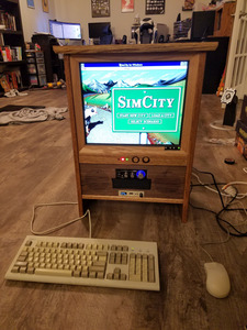

The 486 I swore I'd never build.
First post, by Namrok
Update: This build is done! Here is the finished result.
1.02 MiB
836 views
Original: For years, I've had the itch to build a 486. However, as my stable of PCs grew, I always told myself I didn't need one. I have a K6-2+ that is very versatile. I have a P233 MMX that's no slouch either. I even have a NuXT. None the less, a 486 DX2 was my family's first PC, and holds a place of profound nostalgia for me. So, I finally caved to my impulse to build a 486.
I found a guy selling NOS 486 motherboards from god knows where, that typically wound up auctioning after a few days for $30-50. It was too good an opportunity to resist. I knew I wanted one with VLB, since my father bragging proudly that our family computer had a screaming fast VLB VGA card is among the few details I remember. Had no idea what that even meant back then. Wound up with an Amptron DX-6600, which seems to be an alternate brand for a PCChips M601? Mine appeared to come with some sort of AMD compatibility clock generator preinstalled, so decided to go with an AMD cpu to go with it. Would an Intel still work? I have no clue! The jumpers appeared preconfigured for a 33 Mhz FSB and a DX or DX2 processor.
Motherboard in hand, I rounded it out with 8 MB of 70ns 30-Pin SIMMs, a Cirrus Logic GD5428 VLB card, and the aforementioned AMD DX2.
1.55 MiB
2716 views
I clipped off the Varta battery which had not yet leaked, and it seemed to POST alright with just the DX2, memory and VGA card installed.
1.8 MiB
2716 views
The information available at The Retroweb seemed to indicate it needs a 6V external battery, so I connected a 4 AAA battery case to the appropriate pins, and it appears good.
1.52 MiB
2716 views
Properly detects the 66 Mhz processor too.
1.5 MiB
2716 views
I ordered a Gotek to go with it, and an ES1868 sound card. I already have a compact flash to IDE adapter, and this generic VLB multi IO card, although I haven't tested it yet. We'll see how getting DOS 6.22 installed goes, and then try some benchmarks. I have no expectation of pushing this system to any sort of limits. If I can get some nice average DX2 performance out of it, I'll be more than happy. I have other machines if I want more power.
I have something really exciting, and laborious, planned for the case. I'm really stoked to show it off if I ever get that far.

I want to make a wooden case, roughly in the style of an old TV. Back when TV's looked more like furniture. I want to mount an LCD screen and speakers directly into it, and have panels covering the CD-ROM and GOTEK when I'm not using them. I have a cheapo case I don't care about which I'll probably carve up with my dremel for drive cages and slot brackets.
I'm still working out exactly what design elements of these old TVs I want to incorporate into the case. I'm not the most amazing woodworker, so some compromises will likely have to be made. It will however be made with red oak, likely with an Early American Classic stain. Because the heart wants what the heart wants, and even though my wife hates it something about that combination speaks to me. Probably just a seal coat of Shellac since I want it to be fairly matte in appearance.
I think my plan is to start coming up with design sketches and milling my rough lumber this weekend.

Well, I sketched out what I think I'm gonna try to do. I found myself primarily inspired by the second picture I posted. Going to do similar style grills for the speakers, only moved below the monitor instead of to it's sides. I think I appreciate a taller, leaner profile for an all in one desktop.
648.1 KiB
2072 views
I really don't want to have to glue up panels for the two sides, bottom or top, so if I can make everything fit in a case that's about 9" deep, with the motherboard mounted vertically on the back side, I think I'm good. Might do a mockup with cardboard or something just to see if my idea of having the motherboard hinge outwork to be installed and maintained is remotely feasible. I also need to actually remove the drive cage of my spare case, and see what it's exact dimensions might be, and how I might mount it in a removable fashion.
I think I've also settled on a Kinter amp with 4" speakers. The dimensions look like it could possibly fit inside a drive bay?
