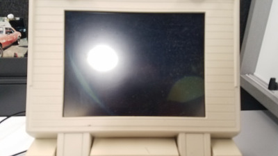

Reply 6 of 22, by trojan2179
I might buy one of these adlib repro cards but I do like the Mediavision thunderboard they say the sound blaster output is pretty good.
May backlight is out but I get an image
Nickel battery leaked but missed the motherboard.
CMOS battery hasn't leaked.

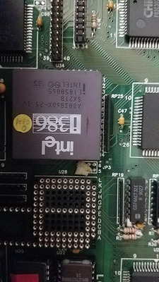

Reply 13 of 22, by trojan2179
Here's the TI Tx486 DLC 40MHz CPU and Cyrix 40mhz Math Co
Reply 14 of 22, by Tiido
I see corrosion at the battery, this will have to be dealth with or sooner or later the machine will need significant repairs.

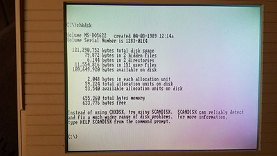

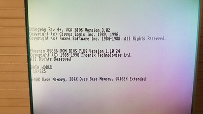

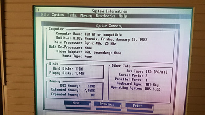

Reply 16 of 22, by trojan2179
Alrighty!! I got the backlight working!
I bought another laptop DataWorld 325 with a broken LCD so I can test / swap parts.
Little sensor that detects if the panel is open or closed was not closing when LCD was open. *I just taped it closed.
4x 4MB SIPP memory 30-pin 60ns 9 chip parity DRAM are only detecting 1MB each.
Only detects 8MB of ram instead of 20MB.
Does not detect Cyrix 487DLC 40mhz Math-co *BIOS state Co-Processor not installed.
120MB Conner hard drive is working but FD controller on MB seems to be bad.
Going to swap motherboards over the weekend.
Going to use my P133 Dell to setup the 120MB Conner hd.
Should have photo's of Doom, Sysinfo and 3dbench tomorrow.

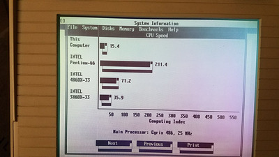

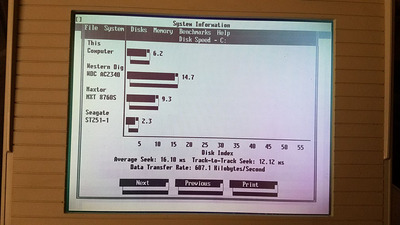

Reply 17 of 22, by trojan2179
Sysinfo
