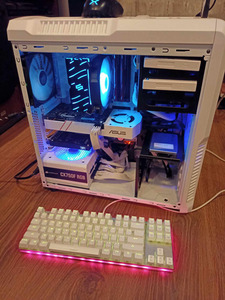

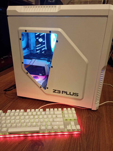

I present to you my new project Ultimate Windows XP Machine - "Maximus"
Purpose of this project:
1. Dual system computer (Win XP x86 and Win 10 64bit) - ultimate hardware components for Windows XP gaming;
2. All Windows XP games must work at highest settings 60+ fps;
3. Benchmarks;
Components in use:
Motherboard: Asus Sabertooth Z97 Mark S (White) ;
CPU: Intel 4790k - fastest 4 cores for LGA 1150 and for Win XP;
CPU Cooler: Ferra3 RGB ;
RAM: 2x 8GB, Trid DDR3-2400C10D-16GTX CL10-12-12-31 1.65v;
GPU: GTX960 4GB White ( I I plan to test MSI GTX780Ti GAMING 3G, GTX970 and ZOTAC GTX980TI AMP! Extreme-faster then Titan.
Sound Card: Creative SB0880 X-Fi Titanium;
PSU: Corsair CX750F RGB White;
HDD: 2xSSD: Crucial MX500 500GB and Plextor PX-512M8VC+;
Blu Ray: Pioneer BDR-212EBK;
CASE: ZALMAN Z3 Plus White;
"Maximus" is ready, powered by GTX 960 4GB, I dont see any problems/errors with 4GB of RAM and 4GB of VRAM working in x32bit system at same time.

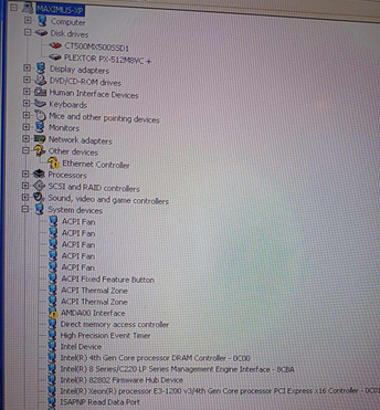

Windows XP installation.
Original Windows XP disk and rufus usb doesnt work. I used Easy2Boot method with ISO from E2B page (en_win_xp_pro_vl_with_sp3_x86_aug2018.iso). Next snappy driver, creative sound drivers from Daniel_K's Official Blog, GPU drivers from NVIDIA official page ( plus ahcipp32.dll and asahxp32.sys from internet).
Devices with missing drivers:
Ethernet Controller (LAN socket) not working but second one works well, (if somebody want to use internet - I want , becouse I want to post my 3dmark scores) .
"AMDA00 Interface" -( temperature sensor ) shows fault, but I dont know is it working or not.
And that all, I was suprised that only those 2 drivers were missing.
Dual boot: I`m entering Boot Menu during start and selecting a boot device with proper system.
I failed in one subject: I did not find drivers for igpu ( 4600HD). Every installation of intel igpu in Windows XP coused black screen after restart. I wanted to compare this igpu (4600HD+DDR3 2400mhz) with HD3850 GDDR3 🙁.

Reply 2 of 13, by Bancho
Cool Specs and a lovely looking machine!
I'm in the process of building a Haswell XP machine (Asus Gryphon Z87, 4770K). I've not chosen a GPU yet.
I too have the same issue with the "AMDA00 Interface" not installing on mine either. Snappy Drive throws an error. Its the only device that didn't install on my machine. Would be interesting if anyone knows how to reseolve it. Don't think it poses an issue but it would be nice to have a Device manager with no warnings 😁
