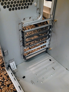

I've recently got a chance to remedy this, and have been collecting parts for a while now. This will not be period correct. Nor will it be a super high performance time machine build. It might end up being an imagined and evolved side system that a younger me would have dreamt of letting live alongside my main modern system, only to play the occasional Longbow 2, EF2000, Redline Racer or NFS3 session on.
Not all decisions are final yet, and I've accumulated way more hardware than I'll end up using.
Only three components are so far set in stone:
3dfx Voodoo 5500 with Heatkiller copper/black acetal blocks, water cooled!
Dell 2007FP 1600x1200 native LCD

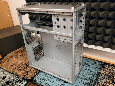

Chieftec Dragon midtower case that I picked up in poor-to-fair condition. I've so far had a most unpleasant experience removing old bitumen mats that were glued on everywhere, and started to mod it to accomodate the water cooling system. It'll need polishing and buffing at some point, as it's been quite badly scratched up by the previous owner, but it's salvageable.

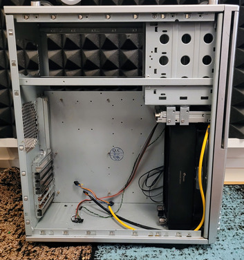

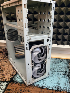

This is the current state of modding the Chieftec case:
1.6 MiB
2025 views
756.1 KiB
2025 views

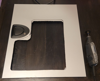

I ended up adapting an aquacomputer bracket as a mount as there were to many features on the front face of the case to simply cut a nice radiator mount straight into it.

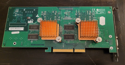

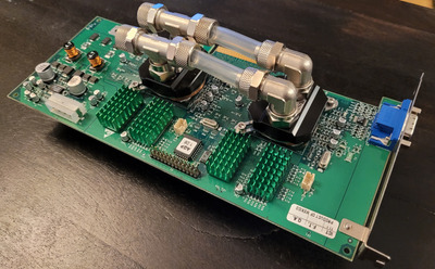

Reply 1 of 23, by nolimitsoya

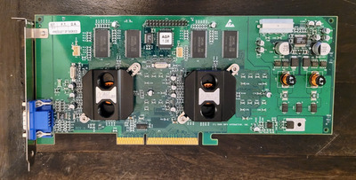

The V5500 has had a full recap and is since then outputting excellent video. Pre recap it did have some artifacting in the form of jittery horizontal lines and generally looked quite soft and blurred. That is now all fixed and it's crisp and flawless!
1.15 MiB
1989 views
1.08 MiB
1989 views
I just recently fitted the Watercool/Heatkiller blocks together with two Enzotech chipset cooler "backplates" on the back. Completely overkill, but I like how it complements the mounting screws that overwise look a bit lonely and out of place. I'm also a bit partial to the look of big chonky chunks of copper on old hardware. 😁 I plan to tie it into a bit of a theme with Enzotech VRM coolers on the motherboard. Possibly a northbridge cooler as well. There are 2 mm thermal pads under the Enzotech coolers to provide electrical insulation and heat transfer. The springs and thumbscrews will probably have to sit on the back like this as they'd interfere with the plumbing on the front.
I'm still waiting for '90s green heatsinks for the RAM and a batch of retro fittings. Hopefully they'll arrive within the next few weeks.

As free breathing as a Dragon chassis is going to get.
1.01 MiB
1989 views
Front panel still fits!
The 240x60 mm Bykski radiator takes up quite a bit of room in the front, but still less than the drive cages used to. The brackets for the FDD may only look hot glued from this angle, but they are double riveted to the 5.1/4" cage with 4.7 mm blind rivets and very sturdy. The hot clue was for finding the positioning and keeping them in place for drilling and riveting.
I'll only be able to use one 3.5" bay as the radiator is blocking the other, and even then it's a tight fit for the radiator. There is only a single millimeter of space between it and the bottom, and about three towards the FDD.

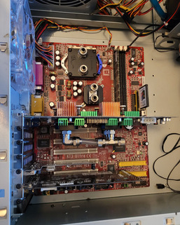

Reply 6 of 23, by nolimitsoya

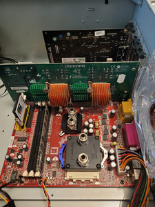

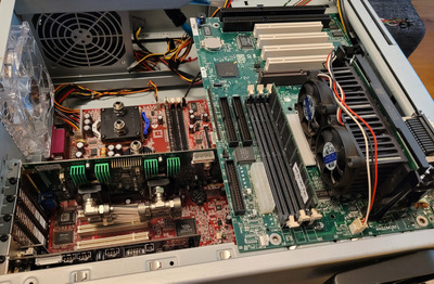

Fittings and sinks have arrived!
1.22 MiB
1332 views
I did a quick mockup just to see how it will turn out. I'm not sure I'm sold on how the red motherboard goes with the V5500, visually. It worked out better in my head. The case fan, however, is a Yate-Loon with quite strong blue LED lighting that I'm still hoping will take the edge out of the contrasting colours once the system is turned on. What do you guys think?

I'm more and more warming up to plan B...
1.81 MiB
1332 views
But, in the mean time!

Reply 9 of 23, by H3nrik V!
I wouldn't trust that water cooler setup - you have absolutely no control whatsoever over the flow - you may only have flow in one block with the other totally stale. I would definetly have the flow serial, to ensure equal and adequate flow in both.
Reply 10 of 23, by nolimitsoya
Parallel flow is no problem at all and even used to be the most common way of connecting SLI setups. The water is flowing under pressure and will always slow down/lower pressure if possible. Meaning, that if there are multiple paths of equal flow resistance the water flow (and pressure) will be divided equally between the two paths.
You can even use this to your advantage if, for some reason, you want lower flow through part of your loop, adjusting flow rate by matching tubing size to the block flow resistance in each branch to get the desired ratio. It can be very helpful in loops including small, restrictive blocks like VRM/VRAM/SSD blocks that you definitely do not want limiting the flow rate of the entire loop and where cooling requirements are lower.
Think of the blocks as resistors in an electrical circuit if that makes more sense. You wouldn't ever have current through only one of two resistors connected in parallel.
