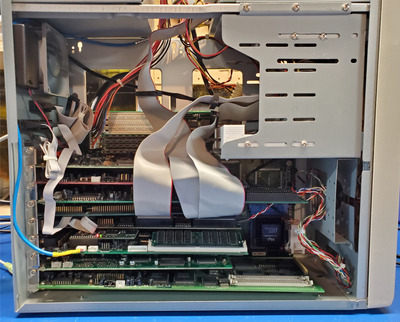

The first challenge for this build was selecting a motherboard and case combo that could accommodate all these cards. I opted for a Socket 3 board that had a total of 8 ISA slots with minimal obstructions on the board itself. I ended up with a 1993 UM486V motherboard.
Based on the sound cards I was planning, I wanted decent performance for games up to the mid-90s. Since this board only support 5V processors, I opted to go with an Intel 486DX-100 OverDrive processor. I also considered a Pentium overdrive instead, but decided to stick with a pure 486 setup.

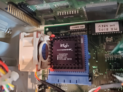

Cooling is provided by a couple Noctua fans. I side-mounted a Noctua 40mm fan to the CPU heatsink directly. There is an additional 80mm fan exhaust fan mounted to the case.
623.2 KiB
1662 views
I did run into an issue with the stock BIOS not recognizing the L2 cache with an overdrive processor installed. Fortunately this was solved by using an alternative MR BIOS version for the UM82C480 chipset.

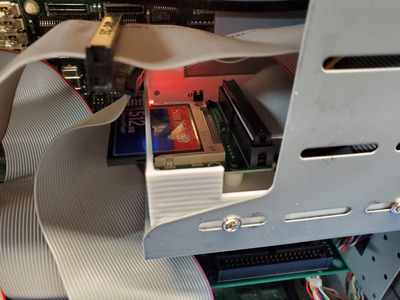

For storage, I went with a standard quad speed CD-ROM, 3.5" floppy and 512MB Compact Flash card. The CF card is mounted internally using a 3D printed drive bay CF-to-IDE adapter.
564.72 KiB
1662 views
Getting everything installed and configured was a bit of a challenge and involved some compromises. But everything is set up so that all cards can be used via a single AUTOEXEC configuration. No batch files or boot menus are needed.
Based on initial testing, most things seem to work. The only incompatibility I've run into has been Warcraft 2 and digital audio for the Reveal Sound FX Wave 32 and PAS16. For whatever reason, digital audio doesn't work properly; the digital sample will constantly restart resulting in a stuttering sound. But digital audio in other games like Descent and Dark Forces works fine.

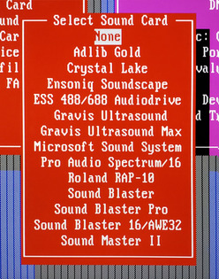

Except for the MIDI port I went with mostly stock hardware settings for the AWE32. This was to ensure broad compatibility with DOS games.
Since the CT3980 version of this card has genuine OPL, it's the primary FM synth card for Adlib support. I haven't installed any extra RAM or an external wavetable card yet, but I may in the future.
For simplicity sake I'm using the UNISOUND driver instead of the Creative Labs driver.

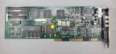

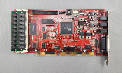

Gravis UltraSound PnP
1.06 MiB
1637 views
Address: 260
Interrupt: 11
DMA: 6
SB emulation, MPU-401, FM: disabled
To set up the GUS PnP, I first disabled a lot of the extranous features (SB emulation, MPU-401 support, Adlib) using IWAVECFG. The GUS was then configured with any free hardware resources.
In testing, I discovered that to avoid issues with games that auto-detect Sound Blaster support (e.g. Wolfenstein 3D), I need to initialize the GUS PnP before initializing other cards like the AWE32.

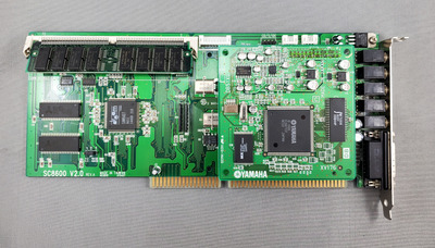

Guillemot Maxi Sound 64 Home Studio Pro (SC8600) + Yamaha DB51XG daughterboard
1.08 MiB
1223 views
Address: 240
Interrupt: 7
DMA: 3
MIDI Port (internal): 320
MIDI Port (external): 300
MIDI Interrupt: 10
FM: 388
The Guillemot Maxi Sound 64 was the biggest challenge to set up. After some experimentation, I ended up using a combination of UNISOUND and the stock DOS drivers to initialize this card. In AUTOEXEC.BAT I run UNISOUND first, followed by the Maxi Sound initialization which loads the firmware and sound bank.
For whatever reason, the Maxi Sound driver doesn't properly enable the external wavetable whereas UNISOUND does. And vise-versa, the Maxi Sound driver is needed to load the sound bank for the internal wavetable.
At the moment I've connected a Yamaha DB51XG daughterboard to this card as an alternative to the Roland sample set.

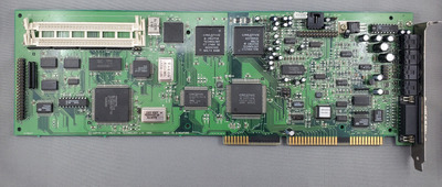

Reveal Sound FX Wave 32 (Ensoniq Soundscape clone)
765.66 KiB
1631 views
Wave Port: 534
MIDI port: 340
MIDI interrupt: 15
DMA: 0
SB emulation: disabled

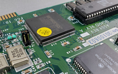

For the Reveal card I used the regular Ensoniq Soundscape DOS drivers. They seem to work fine with this card.
The Reveal card does use different IRQs than the standard Ensoniq Soundcape (e.g. IRQ 15 instead of IRQ 10). Though for this set up it doesn't seem to make a difference.
This particular card required some repair work as it was initially missing a capacitor and the main IC had a lot of loose pins.
690.37 KiB
1631 views

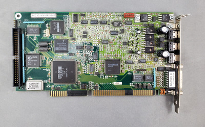

Media Vision Pro Audio Spectrum 16
1.12 MiB
1229 views
Interrupt: 3
DMA: 5
MPU-401 support: disabled
Had to juggle a few DMA channels to get the PAS16 working, but it seems fine with the IRQ 3 and DMA 5 combination.

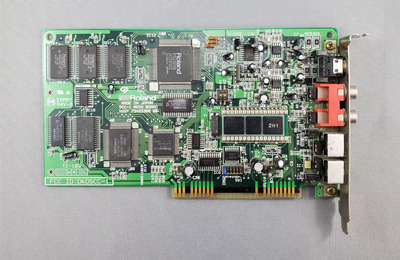

Roland SCC-1
1.02 MiB
1631 views
MIDI port: 330
Interrupt: 2/9
Since the Roland SCC-1 is intended to be the main MIDI-out for any external modules (MT-32, CM-32L), I kept the settings stock for compatibility reasons.

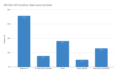

Reply 3 of 20, by Shponglefan
I've done some tweaking to BIOS settings and tried to optimize performance.
BIOS Settings
Cache Timing - Read: 2111 Fast
Cache Timing - Write: 0 WS
DRAM Wait State - Read: 1 WS
DRAM Wait State - Write: 0 WS
I tried 0WS for DRAM Read, but this resulted in the system failing to boot.
Benchmarks
3D Bench 1.0: 71.4
PC Player Bench (320x200): 15.3
Doom (high detail): 36.1
Quake (320x200): 10.1
Duke Nukem 3D (320x200): 26.0
For general Doom-style games from 1993 to 1995 the system performs well enough. Even Duke Nukem 3D is quite playable at 320x200. Quake not so much. A Pentium OD would probably help more with that game, but at that point a full-blown Pentium is a better option anyway.

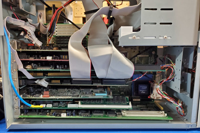

Reply 12 of 20, by Shponglefan
Did some more experimenting and testing over the past couple days.
PAS16 Install
751.91 KiB
1238 views
The first involved removing the Yamaha SW60XG and replacing it with a Media Vision Pro Audio Spectrum 16 (PAS16).
While I had IRQ 3 free, I ended up having to do some DMA juggling to get it to work. This included re-assigning the high DMA channel to 7 for the AWE32, which enabled me to use DMA 5 for the PAS16. I also disabled Sound Blaster and MPU support on the PAS16.
Yamaha DB51XG daughtercard
1.08 MiB
1238 views
Since I still want a Yamaha MIDI synth, I opted to replace the DreamBlaster X16GS with a Yamaha DB51XG daughtercard. I also re-assigned the external MIDI port on the Guillemot card to 300, to match the previous SW60XG port.
I also tried the DreamBlaster X16GS with the AWE32, but unfortunately could not get any MIDI playback. If I tried to use any MIDI port other than 300, I would get a report of a MPU-401 error by game setup programs. If I set to 300, I would simply get silence.
I even tried installing the official Creative Labs drivers, but then I ran into the nightmare of Creative's plug 'n play manager spazzing out and rewriting all my settings.
I haven't really attempted to use wavetable headers on AWE32 cards before. From doing some research, it seems like GM playback is problematic at best with the AWE32. I'll probably just forego it. If I really do want another daughterboard, I can always swap out the SCC-1 for an MPU-401AT instead.

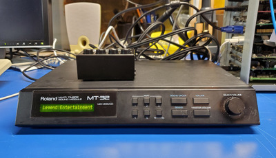

MT-32 Testing
596.81 KiB
1238 views
Finally, I set to work on configuring the SCC-1 for external module playback. I especially wanted to see if I could get full MT-32 support including for games that are IRQ dependent. This meant juggling more IRQ settings. I had previously set the Reveal (Ensoniq Soundscape) card to use IRQ 9, which created a conflict with the SCC-1.
For whatever reason, setting the IRQ to 15 in the hardware setup didn't work. But on the other hand, setting it in the .INI file and then just having it initialize on bootup did work.
Doing that, as well as disabling the IRQ functionality on the video card enabled me to isolate IRQ 2/9 solely to the Roland SCC-1. Tested it with a handful of MT-32 games including Frederik Pohl's Gateway, and this system fully works with the MT-32 now.

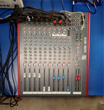

Reply 13 of 20, by Shponglefan

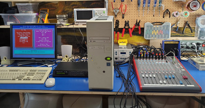

My challenge now is how I'm going to mix all the audio sources.
The primary goal is to be able to mix any MIDI source with any digital audio source.
With the original set up of 4 cards with digital audio and 2 MIDI sources, I planned on a combination of an Edirol M-10MX and an external switch box. MIDI devices would go to the switch box, then output to the M-10MX mixer along with the 4 digital audio sound cards. Since the mixer handles 10 channels (5x stereo), that's an ideal setup.
With 5 digital audio sources (now including the PAS16), I need an extra pair of audio channels to mix everything. I could potentially go the route of submixing or alternatively break out a much larger mixer.

Other games have more options, soundscape been common off top of my head, could be fun to see how many games you can complete the list for 😀
(At least in Doom, I never counted the 3 external midi options, General Midi, WaveBlaster, Sound Canvas. From what I understand all 3 just send the same commands to the midi interface not changing anything to better suit the named device)
Reply 16 of 20, by Shponglefan
chinny22 wrote on 2024-01-10, 23:42:
So you have completed "the list" nice, I've always wanted to do this but lack the hardware and it's fair amount of money for what is really a pointless quest.
Certainly for games like Doom with relatively few audio options, supporting them all is do-able. But as you say, the number of options with later games tends to increase quite a bit for some of them. Trying to have a single system to support all audio choices in a game like Descent, for example, probably not feasible.
283.59 KiB
940 views
I've noticed similar things in other games with both MIDI and FM sources. For example, Warcraft's music options include a variety of FM choices, but they all just output to port 388.
I suppose this was just to make it easier for the end user to ensure they pick the correct option for whatever sound card they had.

Audio mixing was big problem until i built an 4 channel mixer + equaliser to 5.25 bay, from chinese aliexpress components. Everything works exellent now.
That sounds like a cool project. So you have a mixer installed directly into a 5 1/4" bay? How does audio get routed into it?
Pentium 4 Multi-OS Build
486 DX-33 with 5 sound cards
Reply 18 of 20, by Shponglefan
I set up a mixer to be able to fully mix all 6 sound cards, plus external modules. For this I need something with 14 channels and happened to have an Allan & Heath ZED14 mixer on hand.
It's a bit over-the-top size-wise, but it is nice to control over the audio signals including EQ for each device. I may keep this for future projects as the aux routing options will make it easy to do audio recording.

Reply 19 of 20, by chinny22
Man that mixer is almost as big as the PC! but it's just lying around then makes perfect sense.
I run audio extension cables from the back of each PC and manually plug the speakers into which ever PC I'm using at the time, takes a lot less space but naturally no ability to mix different sources
