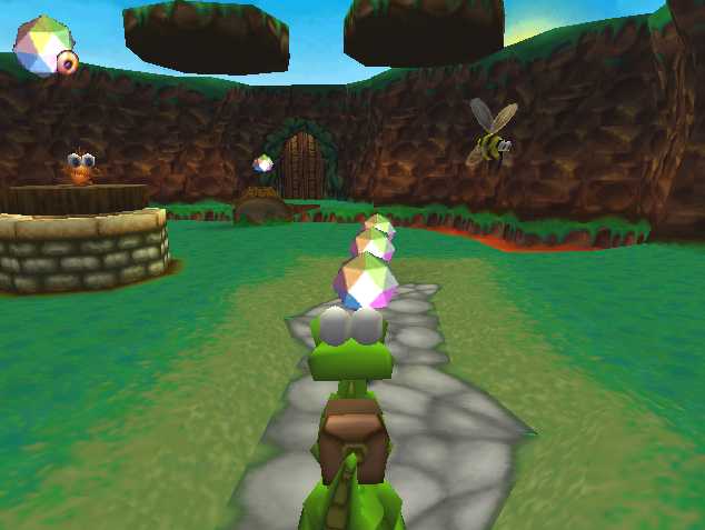

Reply 27 of 47, by Glidos
I think I've fixed the transparency problems. At least
Screamer 2 and Extreme Assault are working correctly now.
Haven't tried Croc yet.
Shall I release it as 009rc3?
That's assuming rc2 doesn't already fix it. I've only just discovered that rc2 exists.
Reply 30 of 47, by Glidos
Okay it should be there now. Chromakeying previously worked only for P8 textures. I've just extended it to 565 textures. We may need to extend it further, but I think this will be enough to catch a lot of the problems.
Reply 31 of 47, by CraigG
You loverly person, you 😀
Looked what you fixed 😁
Only one tiny, weeny little thing.
What happened to windowed mode ?
i.e. When in windowed mode, if you click outside of the game (say the desktop), the window minimises.
It's only a tiny thing, but I sometimes play around with gamma while the game is running. (Nvidia drivers too dark at times)
But Paul, if you were female, I'd give you a huge sloppy kiss right now 😉
