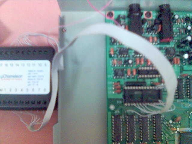

Here's a terrible camera photo of my setup for that rip:
http://www.kingguppy.com/files/MT-32-DAQ.jpg
I'm using the µChameleon to capture the digital data:
http://www.starting-point-systems.com/
There are some limitations:
  • The firmware for doing this sort of streaming is still in beta.
  • The streaming mode is very sensitive to the USB interface used. I only got it working reliably on one PC, and then only with a buffering USB hub attached (which I bought for the purpose on SPS's recommendation). They're working on this, but it's not certain that the problem will be solved.
  • I can only capture 16 bits of data at a time, triggered by a separate line (rising edge, falling edge or - in this case - both). There are 2 more lines going to the demuxer that would be nice to capture since they indicate which time slot is being output at any time. However, in most cases it's easy to determine this from the data going to the DAC.
Positives:
  • I didn't find anything cheaper to get the job done without requiring more electronics skills or time than I had.
  • Starting Point Systems' email support is truly excellent.
I've now switched to capturing from my CM-32L instead of the MT-32, giving a full 16-bit resolution.
Thanks to Lord Nightmare for advice and keeping me motivated.
Reply 24 of 53, by NewRisingSun
Actually, the early MT-32 has 16 bits as well; it's just that the 14th bit is not connected to the DAC, and the lower bits are shifted to the left to fill up the hole. The original 16 bits can be found on those pads to the left of the LA32 chip, right below that "M|1" print.
Not that this will improve the sound quality or anything, just something to keep in mind when using this to find out what the LA32 is doing.

NewRisingSun: I know, but I couldn't actually access the 15th bit (bit 14) easily. I'm using an IC socket wedged on top of the DAC to get at the data lines.
If you give me a MIDI file, and let me know which bit you'd like me to capture, I'd be happy to (preferably no more than ~16s).
