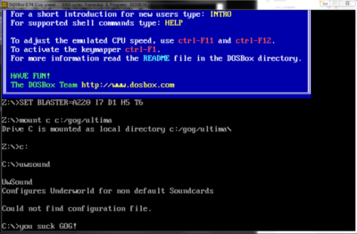

*EDIT* It appears that GOG excised some additional necessary files with this release of Ultima Underwolrd, because this is what happened when I tried to run UWSOUND.EXE...

Reply 16 of 23, by collector
I was playing around with it. I do not have the GOG version, so I do not know the layout for the files. Mine is a CD version with both 1 and 2 on it. When you execute UWSOUND It looks for UW.CFG in the DATA subdirectory. If it finds the default UW.CFG that is on the CD you get that message. If it has been installed the settings will be defined in the DATA/UW.CFG and will then ask what you want to change. I have often noticed that GOG never properly works out CD games. and does a lazy workaround to mount a CD, either an image or a separate folder. If they used the UW1/UW2 CD and you dropped UWSOUND into a folder mounted as the CD it is very likely that it looks to a default UW.CFG.
BTW, an installation of the original installer does not copy any executables to the installed folder. I might be able to work it out if you can post the file layout of GOG's release.

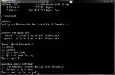

Hey thanks for the insight into the folder directories; with a little monkeying around with the GOG release, I got UWSOUND.EXE to run. Unfortunately, it doesn't provide a solution:
84.27 KiB
3569 views

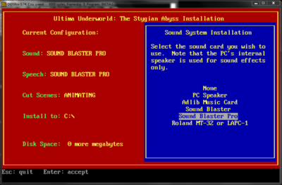

What I did is run the INSTALL.EXE, and I was presented with these options:
90.11 KiB
3569 views
As we can infer from the wording there, your choice of "sound system" is responsible for the music AND sound effects (unless you're using PC Speakers, apparently). Speech as shown in the attached photo is separate. I can verify this from running UW with both Soundblaster selected, and Roland MT-32 in turn, that the music is overpowering the sound effects in both cases.
To me, this is now definitive that this must have been the original intent of Neurath/Spector, because this is clearly how the game shipped. As far as I can see, there's no way to re-balance the music relative to the sound effects, as you cannot select a separate sound card for each; and besides, those Soundblaster sound effects are no comparison to the Roland CM-32L ones!
This is the first time I'm playing Ultima Underworld, so I was kind of expecting an immersive auditory experience as found in later Neurath/Spector games like System Shock, Thief, and Deus Ex where everything is balanced really well out of the gate, or provides volume sliders to adjust as necessary. Thank you one and all for your help with this one!
