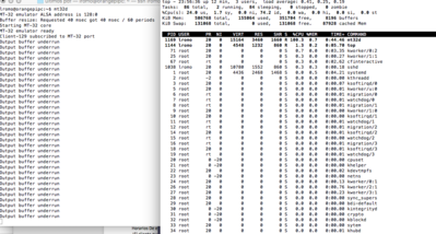

So i compiled this on my orange pi one, seems to work, but i get high cpu usage and constant Output buffer underrun, idk if my device is just underpowered or i did something wrong compiling munt, can anyone give me some pointers?
It could be either one. This is typical behavior for a build of Munt which is either unoptimized or running on an underpowered platform. Please show what you get from uname -a, identify what processor the OPi in question runs, and what compiler version and compiler flags were used to build Munt.
Reply 142 of 292, by kiwa
Thanks,
From uname i get:
Linux orangepipc 3.4.113-sun8i #16 SMP PREEMPT Tue Jun 13 14:15:57 CEST 2017 armv7l GNU/Linux
The cpu:
Architecture: armv7l
Byte Order: Little Endian
CPU(s): 4
On-line CPU(s) list: 0-3
Thread(s) per core: 1
Core(s) per socket: 4
Socket(s): 1
CPU max MHz: 1536.0000
CPU min MHz: 480.0000
gcc version and my flags:
gcc version 4.9.2 (Debian 4.9.2-10)
export CCFLAGS="-Ofast -mcpu=cortex-a53 -mfpu=neon-vfpv4 -funsafe-math-optimizations”
export CXXFLAGS="-Ofast -mcpu=cortex-a53 -mfpu=neon-vfpv4 -funsafe-math-optimizations”
Reply 143 of 292, by gdjacobs
That all looks in order. What does the OrangePi use for a power supply? Could it be downclocking because of low voltage? Could the cores be getting hot and the SoC downclocking to protect itself?
Reply 144 of 292, by mrau
change the governor? in case you see low cpu clocks while under load of course; whats the performance when playing to a file or playing a simple file without emu? how is sound set up in general?
Reply 145 of 292, by gdjacobs
Excellent thought. What is your audio driver? How extensively have you tested it?
