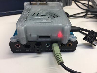

Reply 88 of 292, by FesterBlatz
I got a cheap C-Media based USB sound card working with my Rpi3 and as expected it sounds a lot better than the built in audio.
If anyone's interested, here's a recording I took with my laptop's line-in of the Rpi3 MUNT box playing the Space Quest 3 soundtrack through the USB sound card.
I should note that both the Rpi and daisy-chained USB sound card were only powered by my laptop's USB port, so the Rpi CPU clock was hovering around 900MHz and sometimes dipping even lower. Even at 900MHz mt32d only uses around 60-70% of the CPU, so it seems to handle MUNT quite a bit better than an Rpi2.
https://drive.google.com/file/d/0B4X2cVKW2B3s … UZFckJqUlU/view
Here's what the little setup looks like at the moment.
Enjoy!

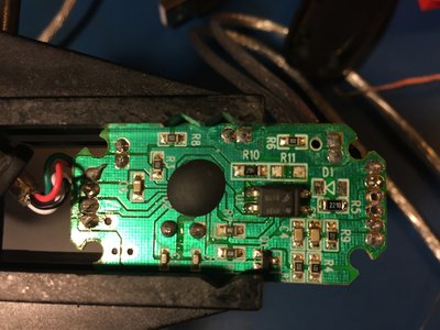

Reply 92 of 292, by FesterBlatz
My $4.99 USB to MIDI cable arrived yesterday and I got it working with my Rpi3 right away. I didn't even bother using it in stock form and added the "missing" optocoupler/220 ohm resistor before even testing it. I already had the needed parts on a scrap board, so it didn't cost me anything to do.
I did some testing and Timidity works flawlessly, but MUNT would spit out occasional errors usually when Sierra titles were programming custom sounds. It was late and I'm suffering from a head-cold so I didn't think to write down what the exact errors were, but they were something along the lines of a particular command not being for this vendor of MT-32 or something like that. For the most part the music and sound effects sounded fine anyway, but I could tell some of the sound were incorrect or not working at all. Quitting the game and restarting would sometimes help, sometimes make it worse.
The sound card I'm using for the MPU-401 interface is an Ensoniq Soundscape OPUS variant called the NEC Harmony. It's basically an OPUS with a modem on-board. Ensoniq's MPU-401 implementation emulates intelligent mode in that it responds to SYSEX commands with an ACK to fool games requiring it into working, but I'm not certain it passes everything on to the external MPU-401 port. I tried with and without SoftMPU running, and my results were definitely better with the SoftMPU TSR present.
Anyway, that's my progress so far! Pretty neat to have a Raspberry Pi connected to my old PC and (mostly) emulating an MT-32...
1.99 MiB
5073 views

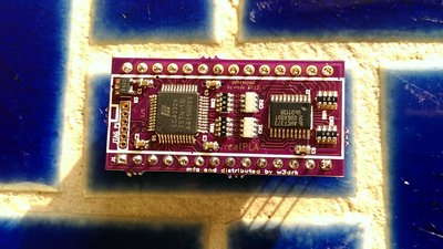

Reply 94 of 292, by FesterBlatz
Thanks! Funny you should say that, I was sort of ashamed to post that picture since I was too lazy to clean up the flux mess.
I do electronics work all the time, this is a far better depiction of how my work usually looks...
1.02 MiB
5313 views
This is a little CPLD circuit that accurately emulates the famous Commodore 64 PLA chip that fails so often with no "NOS" replacements available. It wasn't my design, but I had the PCBs manufactured (used KiCad) and hand-assembled a small batch of them. W3DRK is my amateur radio call sign... 😉
