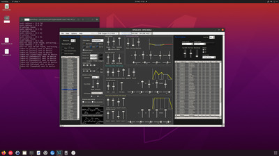

Reply 93 of 132, by sfryers
wyatt8740 wrote on 2024-02-17, 22:34:
I at least ask for support because I DON'T want to make a whole modern windows VM just for sending a handful of bytes to something from the 80s. And also it's a horrible waste of drive space.
Whilst a native cross-platform release is likely to be a while away yet, I do have some positive news to share.
The experimental build included in my latest release, which targets .NET4.7.2 instead of .NET 6, appears to be fully functional on Linux using Wine. I've successfully tested it today on Ubuntu 20.04 with the latest supported versions of Wine, wine-mono.msi, and a hardware MT-32 connected with a Roland UM-ONE USB MIDI adapter. The UI is a bit messy, and it's quite laggy, but it does appear to be working correctly.
819.06 KiB
2018 views
MT32 Editor running on Ubuntu 20.04
MT-32 Editor- a timbre editor and patch librarian for Roland MT-32 compatible devices: https://github.com/sfryers/MT32Editor

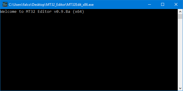

During testing I have noticed that the .NET6 x86 version presents itself as x64 version on the console 😀

Reply 99 of 132, by sfryers
Falcosoft wrote on 2024-04-09, 21:23:
@Sfryers:
Whoops! The string containing the version number which appears in the console and 'About' window is hard-coded, I must have forgotten to change it when I last compiled the x86 version. I've just about finished adding an undo/redo function to the editor, so I'm intending to publish another update this weekend.
