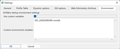

Reply 1783 of 1924, by Neville
I forgot to mention another issue I've been experiencing with DBGL. I may have mentioned before that I have several DBGL installations on my PC. One for playing, and another to test new games / apps I come across. This later install is the only one where I use DBGL betas.
But I've also got another installation of DBGL, this one in my D: drive. Here I keep each and every single one of the DOS games / apps I've ever seen. Some of them require DOSBox-X, which works fine on my other installs. But here for some reason I can't run it. It keeps showing this error message:
Is this a bug or I forgot to do something to get DOSBox-X working?
Reply 1784 of 1924, by _Rob
Don't know why your getting that windib error, but that seems to be an sdl videodriver. From what I found, is that for an SDL1 program directx is the default SDL_VIDEODRIVER, while for an SDL2 version the only option appears to be SDL_VIDEODRIVER=windows
https://wiki.libsdl.org/FAQUsingSDL
Since this seems to be exclusive to SDL1, apparently your using the SDL1 version of DOSBox-X. Does the SDL2 version work?
Reply 1786 of 1924, by _Rob
Is it possible that DBGL is setting the SDL_VIDEODRIVER= environment setting on windows that is causing problems, as SDL_VIDEODRIVER=windib does not appear to be valid for SDL2?
Reply 1787 of 1924, by rcblanke
Neville wrote on 2022-05-01, 20:14:
I forgot to mention another issue I've been experiencing with DBGL. I may have mentioned before that I have several DBGL install […]
You might have customized your dosbox environment like this:
24.74 KiB
2724 views
custom environment settings
If so, disable the customization (un-tick) and try again!

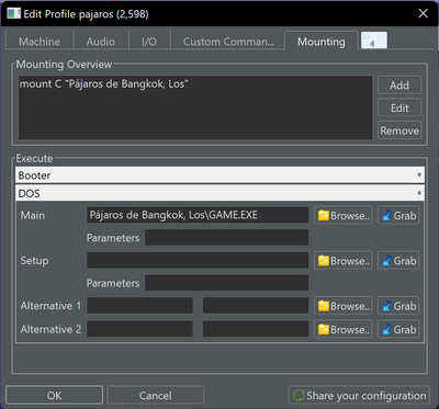

Reply 1798 of 1924, by Neville
For some reason, I'm always the last person to notice these things... I don't think DBGL is handling pathnames with some Spanish characters (such as accents) correctly.
This is one of the problematic profiles:
In some cases, the game works just the same. In others, the folder is not mounted and the game won't run unless I rename the folder without strange characters.
Reply 1799 of 1924, by rcblanke
Strange, I cannot reproduce this problem:
49.88 KiB
1832 views
Pájaros
The dosbox profiles are stored using UTF-8 encoding, so that should be safe. I do happen to know that DOSBox rejects some characters as they are apparently invalid for DOS.
Can you please reply with the copy-pasted name of this folder so I can check the exact character code for your [ á ] ?! And maybe attach the DBGL profiles/pajaros.conf .
