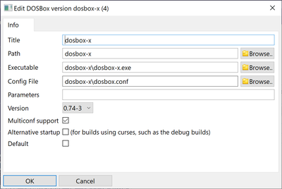

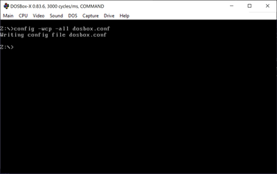

Reply 1588 of 1968, by rcblanke
rotaxt wrote on 2020-11-01, 11:39:
...With Doxbox-X I have problems. It doesn't matter which version I choose, when I try to add it in DBGL under "Dosbox versions", choosing the right path and click ok - I always get the error message: "The Dosbox executable...is missing or unreadable" + "The Dosbox configration file (dosbox.conf) is missing or unreadable".
First create a correct dosbox.conf in your dosbox-x folder by just running dosbox-x.exe and using the command "config -wcp -all dosbox.conf" like this:
46.76 KiB
4208 views
Then, make sure to define the path and the executable in DBGL for dosbox-x.exe like so:
35.58 KiB
4208 views

Reply 1590 of 1968, by rotaxt
rcblanke wrote on 2020-11-01, 20:12:
First create a correct dosbox.conf in your dosbox-x folder by just running dosbox-x.exe and using the command "config -wcp -all […]
thank you so much rc - that works 😀

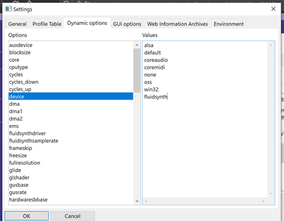

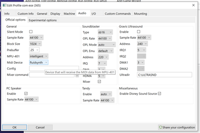

Reply 1591 of 1968, by rcblanke
1) DOSBox-x uses a (afaik) non-standard output mode 'default'. Try setting it to opengl, seems to work for me;
2) add 'fluidsynth' to the possible [midi] devices values, and select it in your profile like so
57.79 KiB
4125 views
86.99 KiB
4125 views

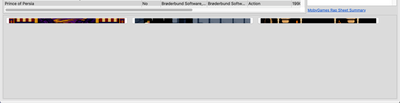

Reply 1592 of 1968, by rfc
Hi,
I upgraded to 0.92 yesterday on Windows and noticed that the thumbnails, whilst preserved, don't show up correctly:
133.72 KiB
4061 views
Clicking on them shows them correctly, so I don't think it's a problem with the images themselves.
I have dbgl on a NAS where I access it via SMB on Windows or also on OSX; I thus added the OSX lib files necessary (swt related) and could also start it there without problems, however the thumbnails render in the same way (in fact, the screenshot is from the OSX version but it's equivalent to the Windows one).
I did (carefully, I hope) overwrite the existing files as not the break my existing configurations and apps/games itself seem to work fine, it's just the thumbnail rendering.
Did I do anything wrong during the upgrade?
I don't recall the previous version TBH, might have been from 2018…
thanks!
Reply 1593 of 1968, by rcblanke
Odd thing; it looks like the screenshot height in px somehow got messed up. Please check File -> Preferences -> GUI options tab, 'Screenshots, Height' and choose a reasonable amount, such as 300px. Then restart DBGL to see if it resolves the issue. If not, please share the contents of your DBGL 'settings.conf', maybe that will give some insight in the cause of the problem.
Reply 1594 of 1968, by rfc
